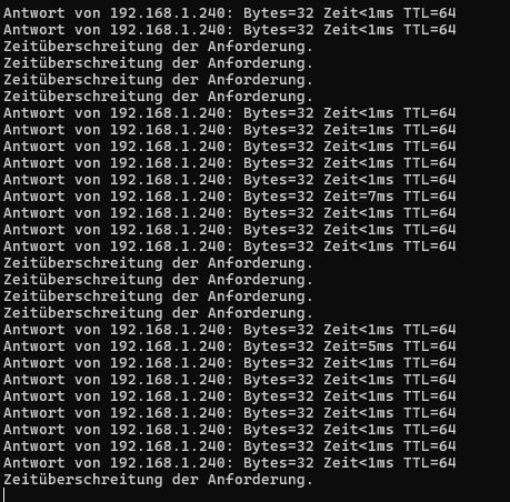

The IP of the bridge is occasionally unavailable
This is my setup:
All switches are connected with 1gbit to the core switch.
The problem is, from my PC, connected to “Buero-Dennis” the ping to the bridge looks like this:

Ping from PC to Buero-Dennis → Stable 1ms
Ping from PC to Firewall (which is connected on Core) → Stable 1ms
Ping from Firewall to Core → occasionally timeouts
Ping from Buero-Dennis to Core → occasionally Timeouts

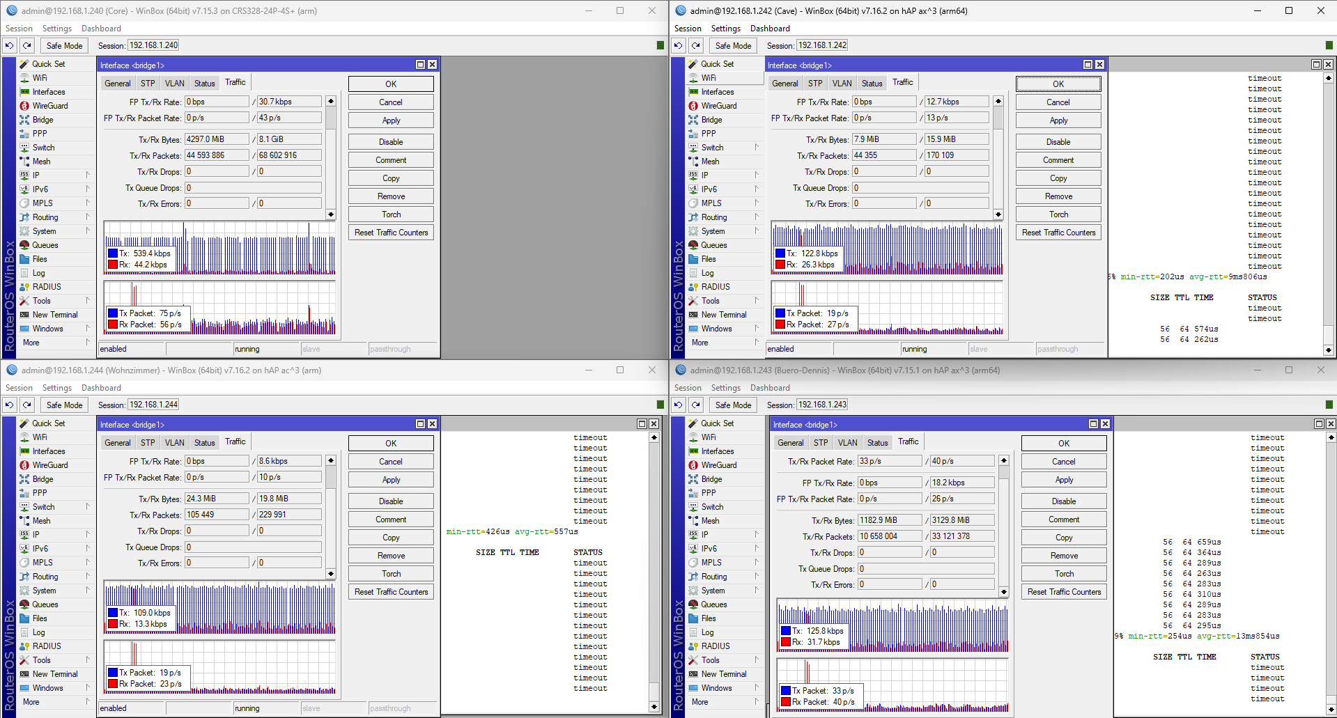

All switches have problems to ping the core switch.
STP was set to RSTP (on all switches), tried now set to NONE (on all switches), no improvement.
Bridge Interface on all switches shows no Drops or Errors.

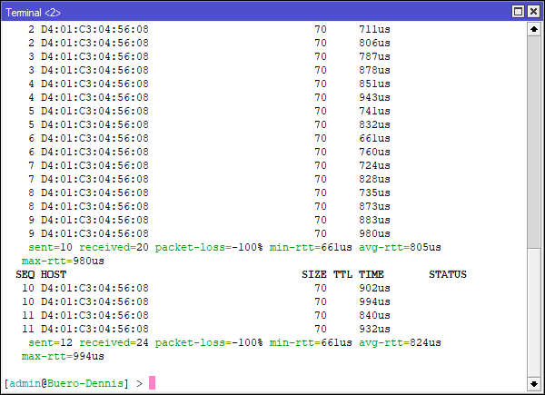

Is it normal that the first interface has the same mac as the bridge?
if i ping the mac of the bridge of the core switch i receive double the amount of packages than i have sent, isn’t that weird? :slight_smile:
This is default behaviour if you don’t set bridge MAC manually (bridge assumes MAC address of first member port).
To the topic: so basically your core switch doesn’t respond to every ping sent at, regardless of where it was sent from. So it might be something about core switch IP configuration (or it might actually be overloaded … run CPU profiler and see if that might be the case).

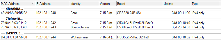

The D4:01:C3… is seemingly the Chateau LTE12? :question:

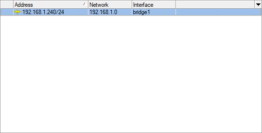

IP configuration of the bridge:
Btw: the coreswitch is also acting as a CAPsMAN, i disabled it, but the timeouts still persist.
No firewall rules present

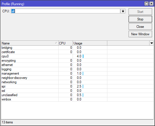

CRS328 has 1 or 2 cores (depending on ROS version running)… so 24% total CPU load can mean one CPU core loaded to almost 50% and that would be a problem. That’s why I suggested to run CPU profiler (it shows load per CPU core and per process). And if CRS is configured properly and used as a switch, it should work with CPU load almost zero.
Thank you guys for your support! I really appreciate it :slight_smile: but the issue still persist :frowning:
All interfaces show no RX/TX drops or errors in the Interface List.
Ah yes, i remember. I checked the configuration - all Interfaces are using Hardware offloading. Profiler screenshot:
Thank you!
Snooops
How does profile output look like while pings are timing out?
The same, i was pinging during the creation of this screenshot
