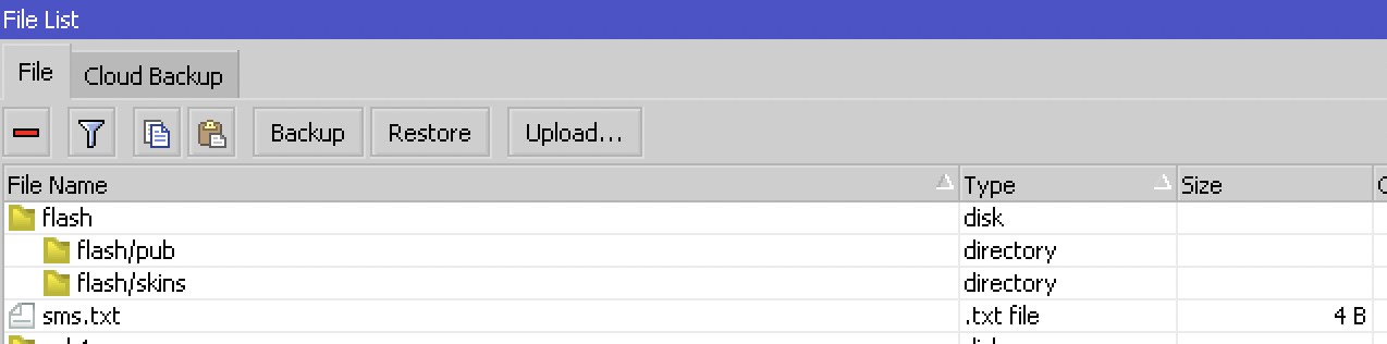

In fact, both options work. And if you tell me how to read the received files, then this will be an almost ideal solution. I write “almost” because for some reason (maybe it’s something wrong with me) after rebooting the router, the file disappears. It has to be copied to another location or renamed.
That depends on the type of router. Unfortunately, MikroTik has missed the chance of defining standard paths of persistent/volatile files.
Now, you will have to check yourself and use a path suitable for your router type and configuration.
Not overhere on ROS 7.10
I’m also on 7.10

> :execute ":put ([/interface lte at-chat lte1 wait=yes input=\"AT+CMGL=4\" as-value ]->\"output\")" file="sms.txt"

you can use flash of usb storage for persistence, depends on device, to save it on flash use
file="flash/sms"
