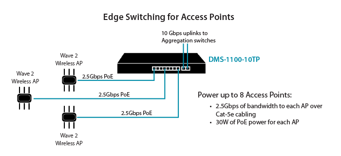

well, I found myself a switch:
http://us.dlink.com/products/business-solutions/dms-1100-10tp/
How can I connect it to hEX now?
