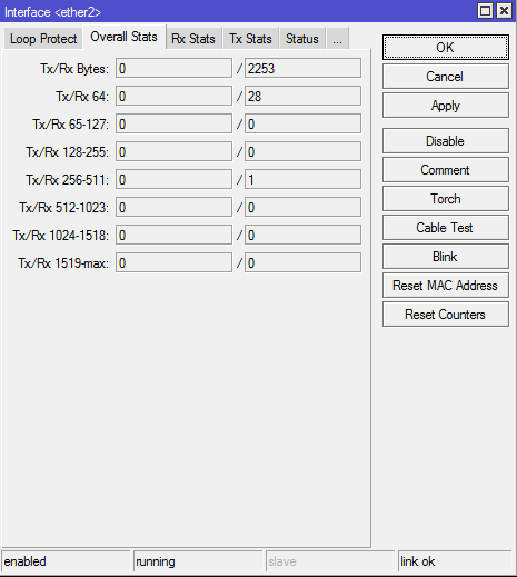

I use Mikrotik RB2011UiAS, in ether1 link ISP1 (IPoE), in ether2 link ISP2 (IPoE). In ether3 must be ISP3 (IPoE). I register settings (ip, subnet, route, DNS) and connect - it does not work. I look at the statistics (Overall Stats) of the ether3 interface and see that the data goes only in one direction: Tx Bytes is always 0, Rx Bytes is constantly growing (screenshot attached).

Next, I try the following: instead of ether3, I switch to the ether2 interface that is obviously working (I’m temporarily disconnecting the ISP2 Megaphone IPoE), but the situation repeats, the provider still doesn’t see the MAC ether2 of my Mikrotik RB2011UiAS. How so?

  • if there is RX packet count, it means the speed was negotiated which means the cable is right. (if ISP didn’t realize it, he has probably no idea what he talks about).
  • bad cable CAN’T affect TX counter because if there is bad cable your device will desperately try to TX, counter will go up, but those frames will never reach destination.
  • empty TX in IP environment can be, by my knowledge, caused only if your router does not even try to send something through the interface. This is usually result of missing IP configuration (either manual or DHCP client), missing route or firewall setting. (It could be also bridge filter setting but I assume you don’t have your WAN Ethernet interface on bridge)
@netmai2000: If you don’t want to share any info about your config (I guess it is secret because you carefully avoided every single piece of your configuration), I can only suggest to start with basics - stuff like ARP pings: since you specify interface, it gets practically pushed through it, no matter whats going on with rest of the config, as long as the interface is running. This will guarantee you a TX packets. Obviously, it does not guarantee, there will be any response, but if your ISP sniffs data, they must see it coming in.
