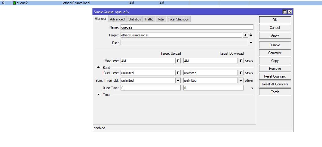

I have a switch CRS125-24G-1S where I configure queues to control the bandwidth of the connected clients but it doesn’t work for me
I did tests configuring in the targe field the ip and also with the interface, it does not work in both ways
I attach images of the configuration

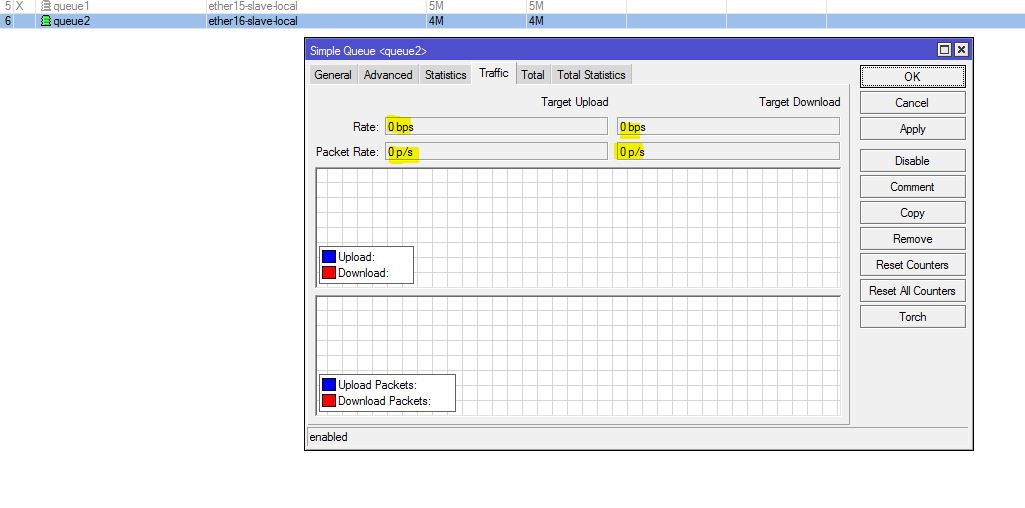

In the traffic tab does not show rate
Please help me to control the bandwidth of the clients by IP or by the Interface

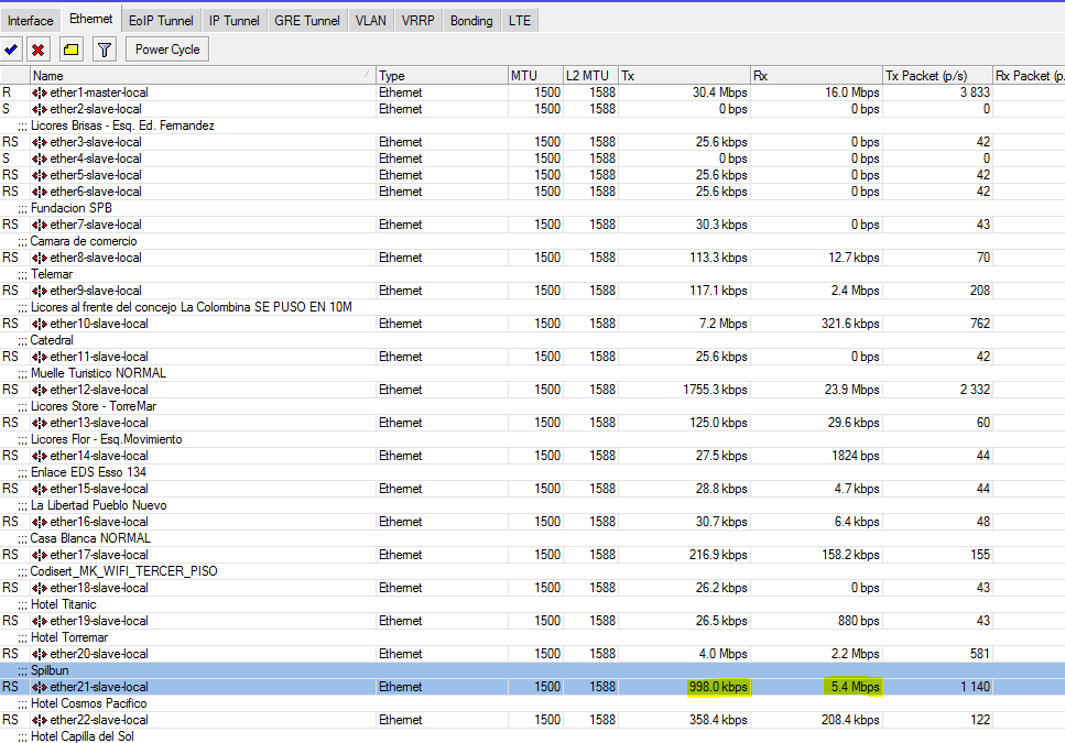

Configure port 21 to limit bandwidth on Tx and Rx
Attached image of what is configured
Checking the traffic on interface 21 I see that it only applies in Tx and not in Rx, you can see in the attached image
How can help me limit Rx bandwidth

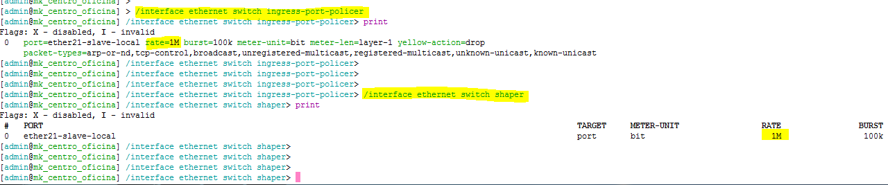

Hi
This is the configuration used:
/interface ethernet switch ingress-port-policer
add port=ether21-slave-local meter-unit=bit rate=1M
/interface ethernet switch shaper
How can help me limit tx bandwidth
