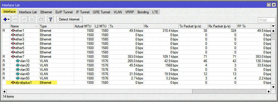

HUAWEI MA5671A SFP >>> This is a GPON SFP module
Why does the HUAWEI MA5671A SFP module WORK in the MikroTik RB2011 SFP port but does not work in the MikroTik RB4011 SFP+ port?

No. An interface is the module that you put into your SFP/SFP+ cage, not the cage itself. The specification of the cage itself is (almost) purely mechanical. And my understanding is that both host software and host hardware must be compatible with the type of transceiver you want to use. It appears RB4011 has some hardware limitations.
Bottom line: please stop yelling, and read the product specs carefully the next time you buy something.

There are a range of SFF specifications, and whilst the electrical interfaces of the 18 contacts and the mechanical dimensions of cage & modules are well defined across SFPs the rate, encoding and interpretation of the data streams very much depends on the type of SFP, e.g.
1000Base-SX/LX/BX = 1.25Gb 8b/10b 1000BaseX
10/100/1000Base-T = 1.25Gb 8b/10b SGMII (converted by IC in SFP from copper manchester/4B5B+MLT3/PAM5)
10GBase-SR/LR = 10.3125Gb 64b/66b PCS
1/2/4/8GFC = 1.0625/2.125/4.25/8.5Gb 8b/10b fibre channel
10GFC = 10.51875Gb 64b/66b fibre channel
GPON = 2.48832/1.24416Gbps G.984 (note this is the most common, but not only implementation of GPON)
The Mikrotik implementation should support anything which presents a 1.25Gb 8b/10b 1000BaseX, 1.25Gb 8b/10b SGMII or 10.3125Gb 64b/66b PCS so this excludes dumb GPON SFPs. I specifically use dumb to indicate media conversion between optical and electrical interfaces as passive is different.
All that said, if you have a smart GPON SFP which presents a G.984 interface on the optical interface with onboard processor for management and protocol handling which presents 1.25Gb 8b/10b 1000BaseX on the SFP electrical interface it should work - this is borne out by people saying that the MA5671A SFP works in RB2011s and unmanaged media converters.
TL;DR:
There is a fault with the RB4011 supporting communication with some gigabit or gigabit-like SFPs (see forum comments about interface not working after upgrading firmware).
Once resolved, the brochure page should more correctly say ‘The RB4011 does not support Passive DAC modules or dumb SFP GPON modules’.
