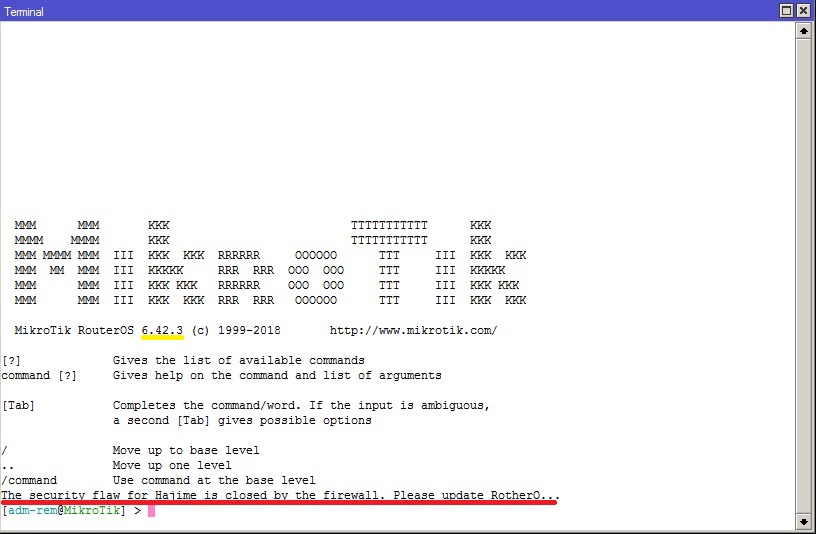

I had such kind of the invasion too.
And now i updated routerOS from 6.41 to 6.42.3. I changed all user’s passwords and update my router from the backup which i had before the invasion.
But i find this string(screenshot) in the terminal window. What is it mean?
This note came from a backup when the routerboard was infected, just a note
. Be calm, the board is no longer infected.
/system note edit note
Delete the text and ctrl with o for saving the changes!
Thanks a lot. I did it and after rebooting this string disappeared. ![]()
