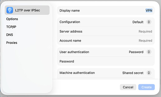

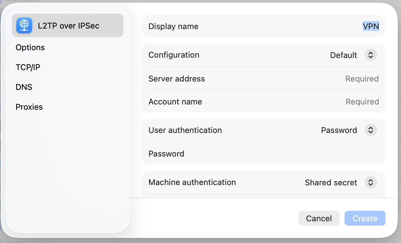

Well, if on clean router, you run QuickSet with the VPN checkbox checked... has all the settings for L2TP, and those all work in Mac without certs. "Just username/password":
Basically L2TP is support by most things. The challenge is the RouterOS configuration is tricky for it. Why I meantion QuickSet, since you can see/test it, then add to your router. Otherwise, a lot of small thing have to align in config (e.g. firewall filter/nat rules) beyond just /ip/ipsec things...
Android be same. It's possible some default may not align, but in general you can get RouterOS to align with very minimal setting changes on L2TP config (in some case, yes, more than "just username/password" but current Mac default should be username/password IF RouterOS has right IPSec stuff all matched.
