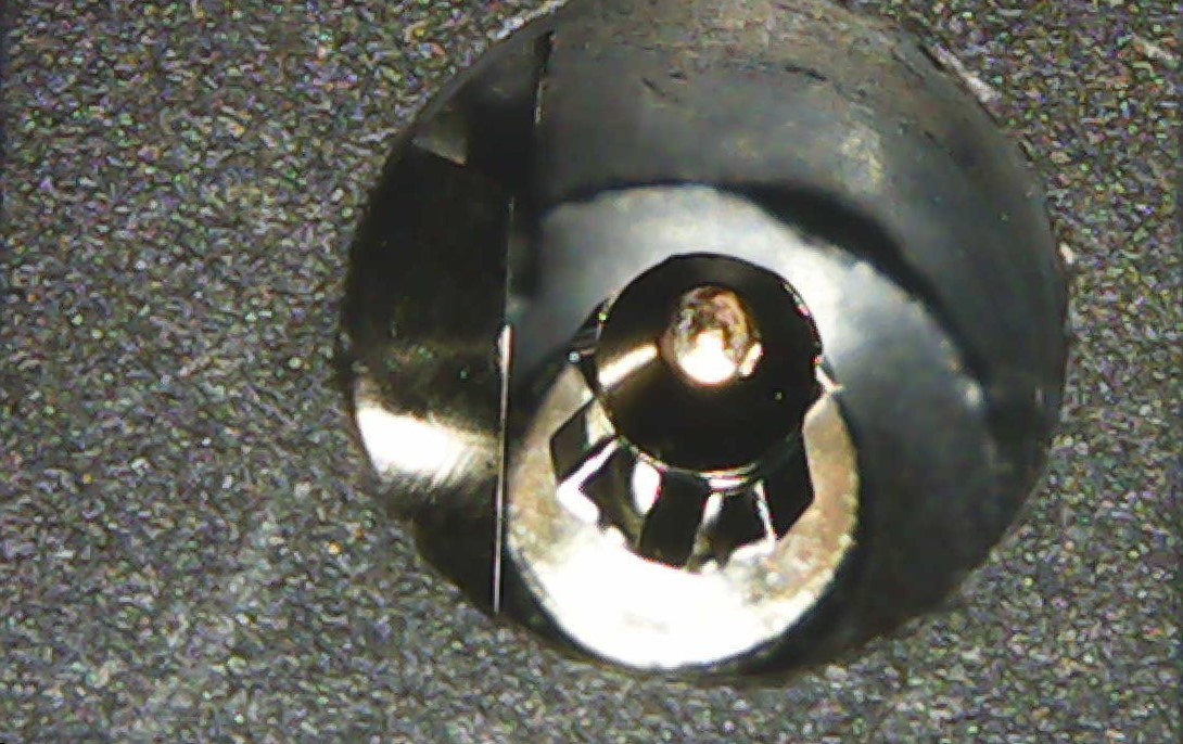

That would mean about 1Amp each at 28V so yeah no go, It wouldn’t be a problem but my Hap ax2 has a faulty power socket which I am now going to have to change, I do have the sockets I just need to install it. So I guess it’s the none PoE one then.
Bought these..
