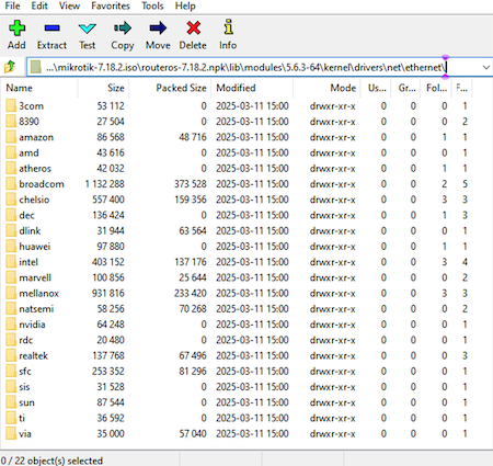

You need to check what hardware those boxes use, like for example network card, storage controller, and so on. Then make sure drivers for those hardware devices are included by default in Linux version 5.6.3. It’s not possible to add any custom drivers yourself.

Obviously not all available on the market, like third-party drivers, but a bunch of Mikrotik legacy and most of the mainstream drivers, like for example the NICs listed below. You simply have to check for each device whether a driver is available.
