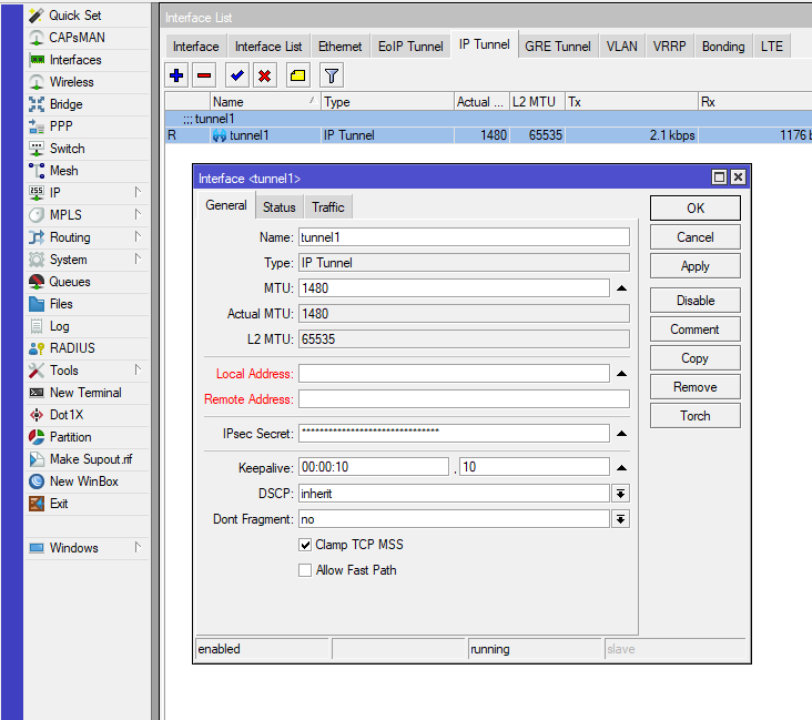

The problem about not use the script, I think, is that if my ISP changes the IP once the router is started, the tunnel will not change by itself. Also, some time ago I tried to put the ddns in the ip tunnel configuration and if I reboot the router and changes the public IPs in the tunnels, the ip’s are not updated, so they do not connect with each other.
I think that where I have to put the ddns so that it works as you indicate is in the red fields of the photo, right?
if you use DNS name, than why you need that script?
I didn’t test exact behaviour, how it deals with address changes, so maybe there is some unexpected glitch. Test it, don’t set Local Address at all (close the field with arrow at the right), put remote hostname in Remote Address, and see how it works. If it does, good. If not, you can either try to debug what wrong, in case it’s some bug. Or just go back to script, if it works for you.
