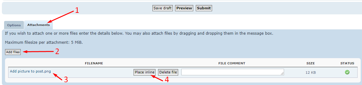

  2. You didn’t attach the image. To do that, click on “Attachments” under the post editing window, then click “Add files”, and upload your picture, then move the cursor to where you want the picture to be displayed in your post, and then click on “Place inline”
