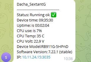

:local sub1 ([/system identity get name])
:local sub2 ([/system clock get time])
:local sub3 ([/system resource get uptime])
:local sub4 ([/system resource get cpu-load])
:local sub5 ([/system resource get board-name])
:local sub6 ([/system resource get version])
:local sub7 10.11.24.15:3035
:local sub8 ([/system health get [find name="temperature"] value])
:local sub9 ([/system health get [find name="voltage"] value])
/ tool fetch url="https://api.telegram.org/bot585388xxxx:AAGsQNsZbO57gc7o-PQMeU9vk12Qxxxxxyw/sendMessage?chat_id=-86348xxxx&text=$sub1 %0A------------------------------------ %0AStatus: Running ok \E2\9C\85 %0ADevice time: $sub2 %0AUptime: is $sub3 %0ACPU use: is $sub4% %0ACPU Temp: $sub8 C %0ACPU Volt: $sub9 V %0ADevice Model:$sub5 %0ASoftware Version: $sub6 %0AIP: $sub7" keep-result=no
it must work
Ok, Thanks.
Its working…:+1:
