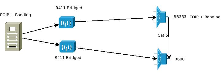

I have set-up a bonded wireless link with eoip . The bonded link works just my throughput is worst than the standard ptp link .
Standard PTP link = 10mbs half duplex on each link
Bonded link = 7mb half duplex and pings stay at 2ms
Have tried all the different modes , no difference
My setup is
1x x86
2x 411 Bridged RB
1x RB333
1x RB600
All routed .. no natting and eoip have been routed correctly.
Pings on bonded interface are 2ms
Nstreme is on
Any ideas why the throughput is so bad ?
