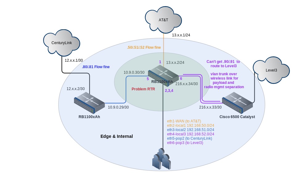

I’m really struggling with getting traffic to route to specific gateways depending on the internal IP Block/Network. My company has acquired a WISP that was designed and deployed by a couple of individuals not really familiar with Networking. So I’ve inherited a network set up with no routing protocols, only Class C networks from one edge to the other (including mgmt), bridged interfaces on the actual PTP links/hops, and so on. My particular problem right now has got me really struggling for an answer. Simply put, I have two active gateways (CenturyLink and AT&T). The AT&T pop are a cluster of T1’s that I want to turn down. My Level3 pop is a 10G circuit. I want to move as much traffic off the AT&T T1’s onto Level3. Move the static IP customers to a new IP Block and in the end drop the T1’s. And so my problem, no matter what I do I cannot get customer traffic to move to another route. The router has a slew of Route Rules, Mangle, and Masq rules. I’ve cleared out most of the Route Rules and unneeded SrcNat’s.
What I’ve tried, as the examples are found everywhere here, blogs, etc, I’ve set up a couple of Mangle rules to Mark Packet for an internal sourced IP address. I then add a routing mark to traffic with the packet mark. I’ve added a default route to Level3 for all traffic with said routing mark. I don’t know what I’m missing. BTW, I have three IP blocks which I successfully employed the same procedure and routed that traffic back to the CenturyLink pop. Inter network routing works, I deployed an OSPF layer with /30’s to get some control of the internal routing and changed the default gateways on all internal routers to use the new /30 hops. Any networks toward the Level3 pop I I specifically add a static route, routes fine. Below are the key config snippets. Here’s an idea of what I’m working with. No doubt you have questions. Any, I mean any, help/suggestions you have I will greatly appreciate! I did trim down the config considerably and obfuscate some IP addresses, but all the basics are here. I hope I didn’t chop it up too much. I’m happy to provide more information as needed. I’m not a long time Mikrotik guy, I do have my Mikrotik Certs and a Cisco Certs and 30 or so years with Cisco and Network topologies. While in principle, practice I think I have what I need in place, I must be missing something.

[admin@mr1.rtr] > ip address print
 #   ADDRESS            NETWORK         INTERFACE
 1   12.x.x.2/25            12.x.x.0           eth1_WAN
41   192.168.50.1/24    192.168.50.0    eth2_local1
43   192.168.51.1/24    192.168.51.0    eth2_local1
41   192.168.52.1/24    192.168.52.0    eth2_local1
43   192.168.80.1/24    192.168.80.0    eth3_local2
41   192.168.81.1/24    192.168.81.0    eth3_local2
43   192.168.90.1/24    192.168.90.0    eth4_local3
41   192.168.91.1/24    192.168.91.0    eth4_local3
65   216.x.x.34/30       216.x.x.32       vlan558
[admin@mr1.rtr] > /ip route print
 1 A S  ;;; Route to ATT Circuits (T1's)
        0.0.0.0/0                          12.x.x.1                  1
 2 A S  ;;; To CenturyLInk for Marked Traffic
        0.0.0.0/0          10.9.0.30       10.9.0.29                 1
	;;; To Level3 for Marked Traffic
 3 A S  0.0.0.0/0                          216.x.x.33                1
64  ADC  12.x.x.0/25        12.x.x.2       eth1-WAN                  0
105 ADC  192.168.50.0/24    192.168.50.1   eth2_local1               0
106 ADC  192.168.51.0/24    192.168.51.1   eth2_local1               0
107 ADC  192.168.52.0/24    192.168.52.1   eth2_local1               0
119 ADC  192.168.80.0/24    192.168.80.1   eth3_local2               0
120 ADC  192.168.81.0/24    192.168.81.1   eth3_local2               0
124 ADC  192.168.90.0/24    192.168.90.1   eth4_local3               0
126 ADC  192.168.91.0/24    192.168.91.1   eth4_local3               0
131 ADC  216.x.x.32/30      216.x.x.34     vlan558                   0
[admin@mr1.rtr] > /ip firewall address-list print
Flags: X - disabled, D - dynamic
 #   LIST                    ADDRESS                         TIMEOUT
 8   ToCenturyLink           192.168.80.0/24
10   ToCenturyLink           192.168.81.0/24
12   ToLevel3                192.168.90.0/24
13   ToLevel3                192.168.91.0/24
[admin@mr1.rtr] > /ip firewall mangle print
 0 X ;;; To CenturyLink - Mark Packet - See Address Lists
     chain=prerouting action=mark-packet new-packet-mark=ToCenturyLinkPM
     passthrough=yes src-address-list=ToCenturyLink
 1 X ;;; To CenturyLink - Mark Route with marked packets
     chain=prerouting action=mark-routing new-routing-mark=ToCenturyLinkRM
     passthrough=no packet-mark=ToCenturyLinkPM
14   ;;; To Level3 - Mark Packet - See Address Lists
     chain=prerouting action=mark-packet new-packet-mark=ToLevel3PM
     passthrough=yes src-address-list=ToLevel3
15   ;;; To Level3 - Mark Route with marked packets
     chain=prerouting action=mark-routing new-routing-mark=ToLevel3RM
     passthrough=yes packet-mark=ToLevel3PM
[admin@mr1.rtr] >  /ip firewall nat print
88   chain=srcnat action=masquerade src-address=192.168.50.0/24
89   chain=srcnat action=masquerade src-address=192.168.51.0/24
90   chain=srcnat action=masquerade src-address=192.168.52.0/24
91   chain=srcnat action=masquerade src-address=192.168.80.0/24
92   chain=srcnat action=masquerade src-address=192.168.81.0/24
93   chain=srcnat action=masquerade src-address=192.168.90.0/24
94   chain=srcnat action=masquerade src-address=192.168.91.0/24
96   ;;; Main masquerade rule. Do not disable!
     chain=srcnat action=masquerade to-addresses=0.0.0.0
     out-interface=eth1_WAN
try this with passthrough=yes ..
