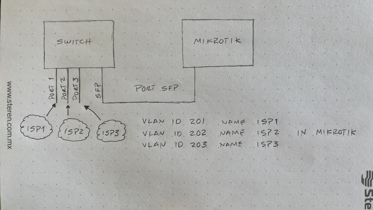

I’m trying to pass 3 pppoe clients from a switch to a mikrotik router, but only one client connects at a time and not all three at the same time, I leave you the images of my configuration, I don’t know if I’m overlooking something.

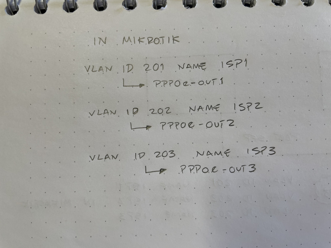

I will try to explain it, to a switch I connect the three services of my isp (ether1, ether2, ether3) through the sfp port of the switch I connect to the mikrotik, in the sfp port of the mikrotik I create three vlans (isp1 id=201, isp2 id=202 , isp3 id=203) I create a pppoe-client for those three vlans, I’ll pass you a diagram, forgive my English and my drawing.

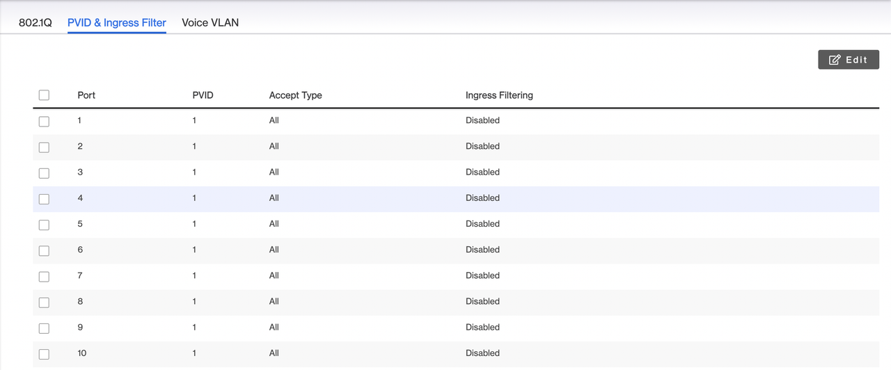

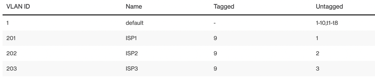

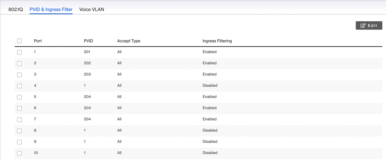

The switch connfiguration looks incorrect as VLAN 1 should not be set to untagged on ports 1, 2 or 3. You can only have one untagged VLAN on a port, not all devices enforce this in their settings so you can configure invalid setups.
All three PPPoE clients are shown as running. Just creating multiple WAN interfaces will not automatically share traffic across them, you have to set up load balancing correcponding to your requirements.

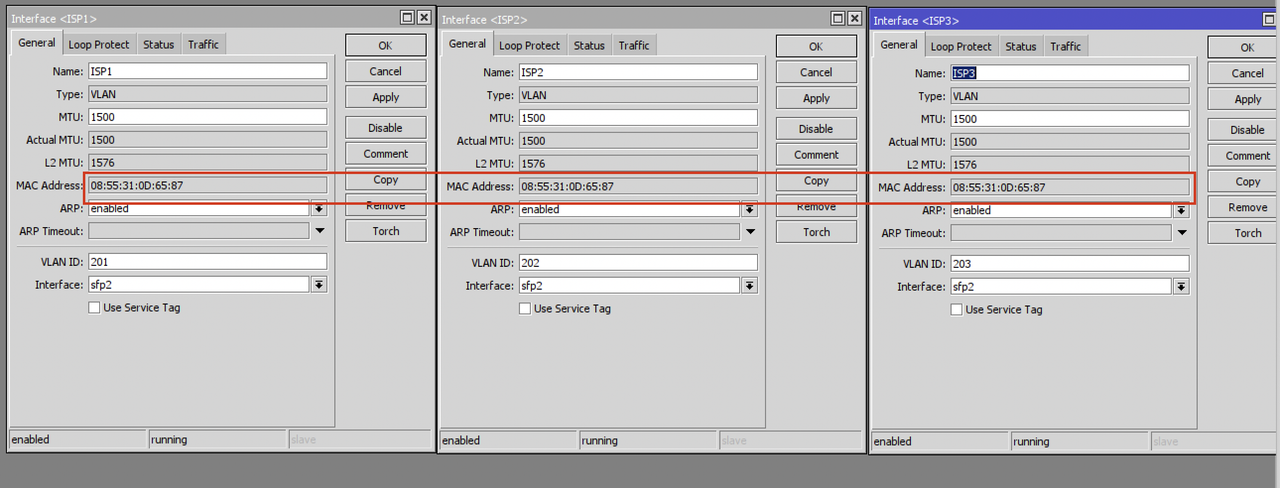

That is correct…
But are you sure those VLANs are passed correctly from the Switch to the MikroTik ? e.g. is the Vlan configuration on the Switch correct ?

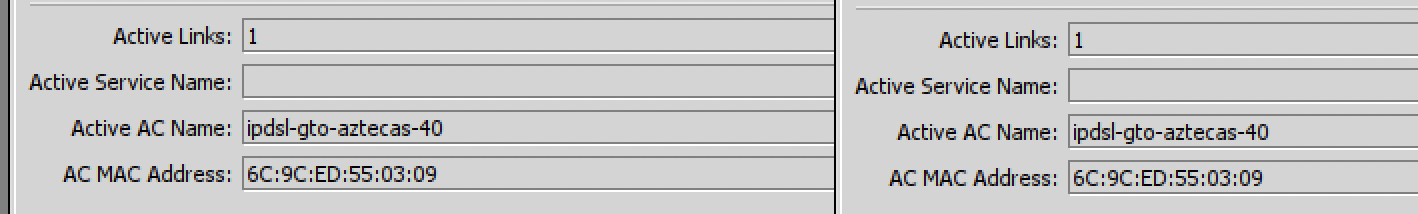

If you do a PPPoE scan on the non running PPPoE clients on the MikoTik, do you see any ACs discovered ?
OK, the network layout is clear now.

/interface vlan
add interface=sfp2 name=ISP1 vlan-id=201
add interface=sfp2 name=ISP2 vlan-id=202
add interface=sfp2 name=ISP3 vlan-id=203
The above code is enough for the PPPoE client to Run on those Vlan interfaces, ISP1, ISP2 and ISP3.
e.g.
/interface pppoe-client
add disabled=no interface=ISP1 name=pppoe-isp1
add disabled=no interface=ISP2 name=pppoe-isp2
add disabled=no interface=ISP3 name=pppoe-isp3
So if they do not go on Running state , i still believe you have a misconfiguration on your other switch …
The strange thing is that only one is executed and not all three, I leave images of the switch config.
I just noticed that all three vlans have the same mac address
That is ok.
They inherit the MAC of the interface they run on…
I noticed on your other switch, you have set the PVID value… However, we set the PVID value on Access Ports…
Between the other switch and the MikroTIK, you have a Trunk Port, meaning a port that passes multiple VLANs.
So on your other switch, instead of using the PVID value, you should create Tagged ports for the particular VLANs mentioned earlier.
If I disable pvid and tag the ports, no vlan works.
Switching looks fine.
It should be untagged on the ingress ports from the ISP’s, tagged on the egress port to the router.
Are the 3 ISP links using:
  1. Same ISP?
  2. Same Username?
  3. Connecting to the same PPPoE Server somehow like a vISP setup? (Do you get the same service name on each pppoe client?)
Either way, show us a full export of your mikrotik router /export hide-sensitive so we can see a bit more about the setup and if there’s a misconfiguration.
1.- yes.
2.- no.
3.-image

I’m 99% sure that will be the fact of the ISP limiting one connection per mac.
Good way to test, rather then send one into the switch, plug it directly in to another port on the router (or route the VLAN to another port on the router) so you end up with a different client mac. VLANs don’t get their own MAC they share the physical port, so you’ll have to route them via different ports or talk to your ISP about allowing this for your connections.

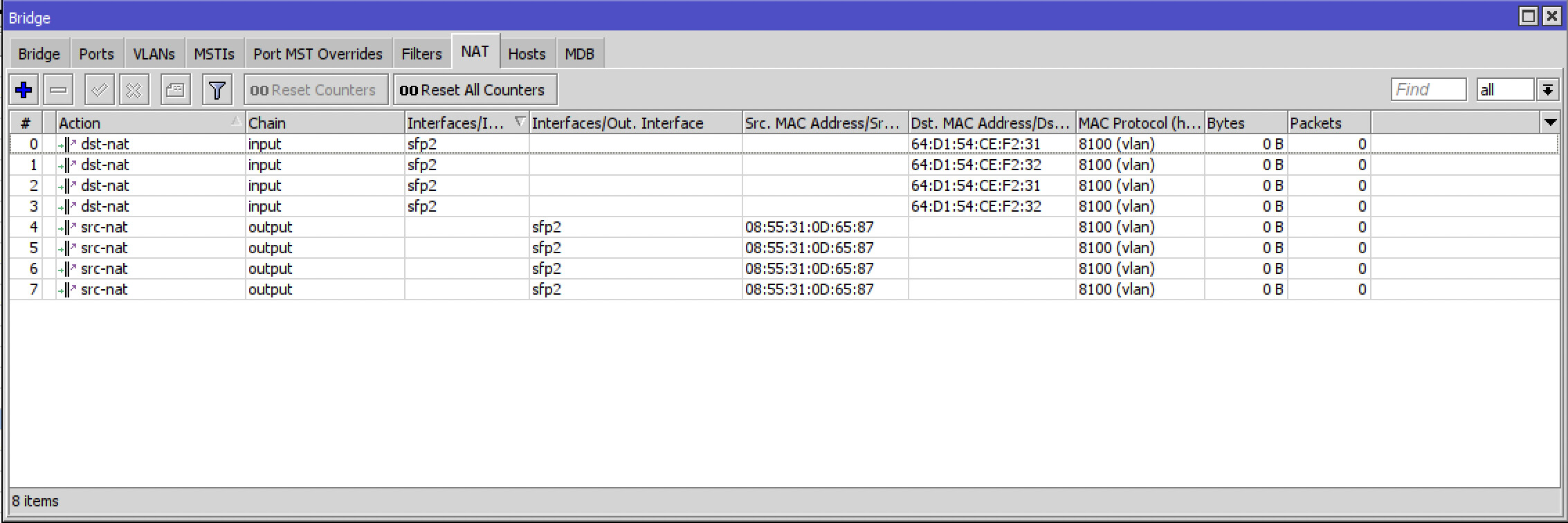

It should be possible to use /interface bridge nat to make the ISP see each of your PPPoE clients with a distinct MAC address while using VLANs on the same bridge and therefore with the same actual MAC address. I’d only alias the MAC addresses for two VLANs. And I’d use MAC addresses of other interfaces of the Mikrotik as the aliases, or you may use MAC addresses of some devices you are sure you’ll never connect to the switch - like some of your old gear not used any more.
add chain=input in-interface=sfp2 dst-mac-address=08:55:31:0D:65:88/FF:FF:FF:FF:FF:FF mac-protocol=vlan vlan-id=202 vlan-encap=pppoe-discovery action=dst-nat to-dst-mac-address=08:55:31:0D:65:87
add chain=input in-interface=sfp2 dst-mac-address=08:55:31:0D:65:89/FF:FF:FF:FF:FF:FF mac-protocol=vlan vlan-id=203 vlan-encap=pppoe-discovery action=dst-nat to-dst-mac-address=08:55:31:0D:65:87
id=202 vlan-encap=pppoe action=dst-nat to-dst-mac-address=08:55:31:0D:65:87
id=203 vlan-encap=pppoe action=dst-nat to-dst-mac-address=08:55:31:0D:65:87
add chain=output out-interface=sfp2 src-mac-address=08:55:31:0D:65:87/FF:FF:FF:FF:FF:FF mac-protocol=vlan vlan-id=202 vlan-encap=pppoe-discovery action=src-nat to-src-mac-address=08:55:31:0D:65:89
add chain=output out-interface=sfp2 src-mac-address=08:55:31:0D:65:87/FF:FF:FF:FF:FF:FF mac-protocol=vlan vlan-id=203 vlan-encap=pppoe-discovery action=src-nat to-src-mac-address=08:55:31:0D:65:89
add chain=output out-interface=sfp2 src-mac-address=08:55:31:0D:65:87/FF:FF:FF:FF:FF:FF mac-protocol=vlan vlan-id=202 vlan-encap=pppoe action=src-nat to-src-mac-address=08:55:31:0D:65:89
add chain=output out-interface=sfp2 src-mac-address=08:55:31:0D:65:87/FF:FF:FF:FF:FF:FF mac-protocol=vlan vlan-id=203 vlan-encap=pppoe action=src-nat to-src-mac-address=08:55:31:0D:65:89
Depending on your CPU architecture, there may be an issue - on some architectures, the vlan-encap value has to be configured as a numeric value with swapped bytes, i.e. 0x6388 instead of pppoe-discovery and 0x6488 instead of pppoe.
Great, thanks for the solution, the model of my equipment is: CCR1036-12G-4S I’m going to try.
I already did the test, but for some reason it doesn’t work, I noticed that there is no packet count in the rules, I used the mac address of two computers that I don’t use on the network.
add chain=input in-interface=sfp2 dst-mac-address=64:D1:54:CE:F2:31/FF:FF:FF:FF:FF:FF mac-protocol=vlan vlan-id=202  vlan-encap=pppoe-discovery action=dst-nat to-dst-mac-address=08:55:31:0D:65:87
add chain=input in-interface=sfp2 dst-mac-address=64:D1:54:CE:F2:32/FF:FF:FF:FF:FF:FF mac-protocol=vlan vlan-id=203  vlan-encap=pppoe-discovery action=dst-nat to-dst-mac-address=08:55:31:0D:65:87
add chain=input in-interface=sfp2 dst-mac-address=64:D1:54:CE:F2:31/FF:FF:FF:FF:FF:FF mac-protocol=vlan vlan-id=202  vlan-encap=pppoe action=dst-nat to-dst-mac-address=08:55:31:0D:65:87
add chain=input in-interface=sfp2 dst-mac-address=64:D1:54:CE:F2:32/FF:FF:FF:FF:FF:FF mac-protocol=vlan vlan-id=203  vlan-encap=pppoe action=dst-nat to-dst-mac-address=08:55:31:0D:65:87
add chain=output out-interface=sfp2 src-mac-address=08:55:31:0D:65:87/FF:FF:FF:FF:FF:FF mac-protocol=vlan vlan-id=202  vlan-encap=pppoe-discovery action=src-nat to-src-mac-address=64:D1:54:CE:F2:31
add chain=output out-interface=sfp2 src-mac-address=08:55:31:0D:65:87/FF:FF:FF:FF:FF:FF mac-protocol=vlan vlan-id=203  vlan-encap=pppoe-discovery action=src-nat to-src-mac-address=64:D1:54:CE:F2:32
add chain=output out-interface=sfp2 src-mac-address=08:55:31:0D:65:87/FF:FF:FF:FF:FF:FF mac-protocol=vlan vlan-id=202  vlan-encap=pppoe action=src-nat to-src-mac-address=64:D1:54:CE:F2:31
add chain=output out-interface=sfp2 src-mac-address=08:55:31:0D:65:87/FF:FF:FF:FF:FF:FF mac-protocol=vlan vlan-id=203  vlan-encap=pppoe action=src-nat to-src-mac-address=64:D1:54:CE:F2:32
Maybe the endianness issue affects the TILE architecture as well. Try replacing pppoe-discovery by 0x6388 and pppoe by 0x6488 in the rules as I’ve suggested.
In the last posted configuration the interface to the switch, and onward to the WAN connections, is not in a bridge. Should be something like
add name=bridge protocol-mode=none
add bridge=bridge interface=sfp2
/interface vlan
add interface=sfp2bridge name=ISP1 vlan-id=201
add interface=sfp2bridge name=ISP2 vlan-id=202
add interface=sfp2bridge name=ISP3 vlan-id=203
add interface=sfp2bridge name=OFICINA vlan-id=204
Thanks, add bridge :laughing:
