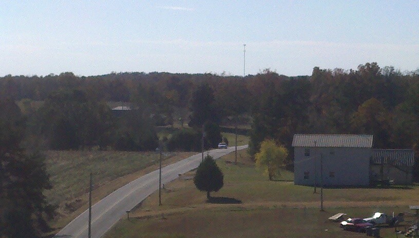

I am working on Deploying my very own equipment! I have no help here where I live and I have installed a 83’ tower. I have my rb711 at around 73’. I have installed a second client board and antenna onto my truck. Both antennas are 24 dbi matching parabolic grid antennas. I am not able to make these antennas perform like my service provider did. Why is it I cant get threw the tree’s like my isp did? The signals appear to be weak.
At the top of my tower when securely tied to it, I can visibly see the top of another tower 3 miles away (trying to hit the house by that tower.) I can see the trees there about 60 foot tall. It’s the only trees blocking my view to where I park my truck at that house to try and get a signal.I have an ladder rack on my truck that I use to mount the antenna. I’ll try to get a picture of that on here. Why cant I get threw the (line of trees)? my isp went threw 3 miles of trees and I cant get threw 1 line of them with the same equipment. I am using the exact same client RB711 version 3 that he used with me. It was programmed to my newly purchased version 4 RB711 as an access point. Is it possible he was using a more powerfull or different AP? I am stunned in confusion thinking I have something improperly programmed which is why I was playing with the Channel Bandwidth in the other post. I have only done testing with factory set Channel Bandwidth on whatever it comes set on.
Can someone help me find my problem? There’s a highway at the bottom of the tower where I park along the tree line. (Tower In Picture)

{The tower in the picture, you can almost see the towers ground if it weren’t for those trees.}

I make sure i have good connections on both sides. I then drive to the second location with my laptop showing me the signal strength. Antenna mounted on truck. I hit the desired location and point the antenna in the proper direction threw the line of trees on the ground with no success. I was under the impression since my isp used the same eqipment and went threw a great amount of trees i could too. Its not working and im not able to install a tower to test if theres a signal there. I would have to strike a deal with a homeowner but first i must get a signal right? Thanks.
