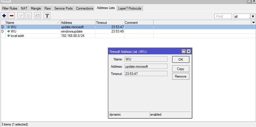

yes because in latert ROS address list are dynamic too if you place a name instead of ip
i cant remember from which version and after this feature was added.
update. …
i found it 6.36
firewall - allow to add domain name to address-lists (dynamic entries for resolved addresses will be added to specified list);
6.36.1
address-list - allow DNS names with “_” symbol;
doesn’t seem to work
you would need to be able to add something like this
~.update.microsoft.com
doesn’t accept ~. or *.
Wolter
