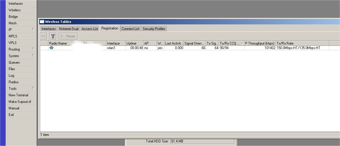

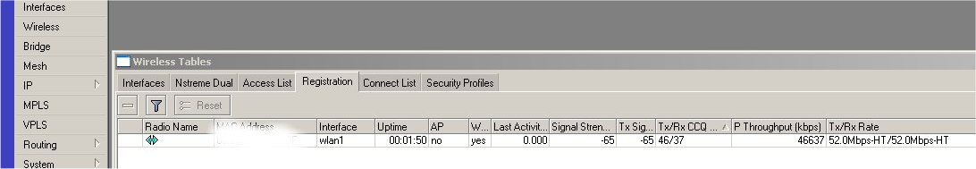

i have a ptp link with two RB600 with R52N card and two Pac Wireless dual polarized antenna: signal is good (about -65 dbm) and also CCQ and throughput (see wirelessn1.jpg) but when i execute a bandwidth test (not from routerboard but from two PC that are connected directly on routerboard), CCQ and also throughput go down (see wirelessn2.jpg): why?
May be an antenna problem? I try to change a lot of field (disable nstream, disable noise immunity, ecc.) in wireless configuration but problem persist. I also try to use only one chain but never.
