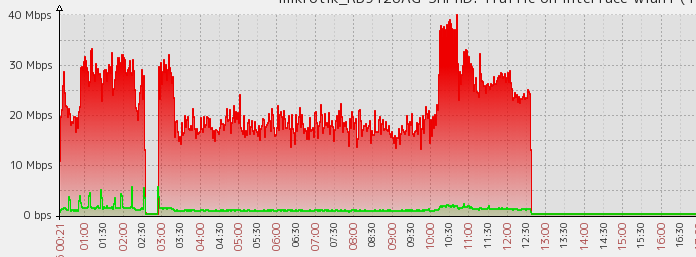

Throughput does not come out.
Currently, we are developing a Wireless LAN environment configuration such as the following in my environment,
but worried that the throughput does not come out when you transfer large files.
Or normally wonder the extent this?
Can you tell me if there is a place that can be tuned?
ROS 6.4
[NAS] — [RB951G-2HnD] — [RB-912UAG-5HPnD(AP)] — (10m) ---- [RB SXT G-5HPnD r2(Client)] — [RB2011UAS] — [PC ]
