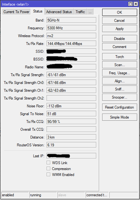

Hi, I have a link configured (2x 5HPnD, distance 2km) for testing issue. I use the nv2 protocoll, N only, without encryption, both chains activated in routing mode.
When I use the bandwidth test from antenna to antenne it is about 100MBit, so perfect.

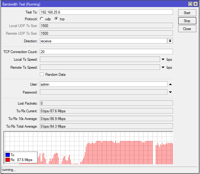

Bandwith between antennas: (UDP little higher, TCP as shown)

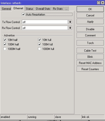

I think I know where the problem comes from: you start from Gigabit ethernet and somewhere on the link you are using Fast ethernet (maybe the end computer). This is a very BIG and OLD ISSUE with nv2 and gigabit that I can’t imagine why it is still here.
Try this setting for every gigabit device on that link to force it into FastEthernet autonegotiation:
So, if you find this useful please everyone write to support@mikrotik.com. They need to resolve this otherwise the gigabit ports are USELESS.

NOT really. It is giving some improvements but is limiting the throughput to 100 Mbps and this BUG applies even for AC devices. :frowning:
