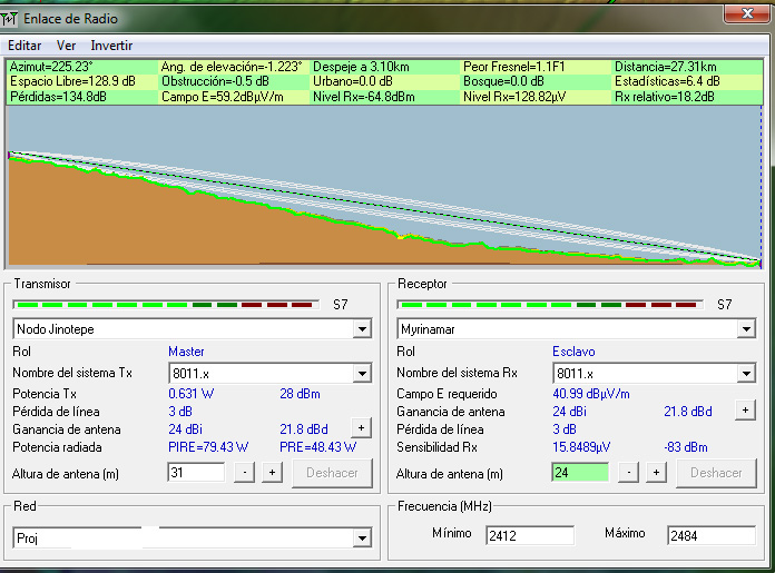

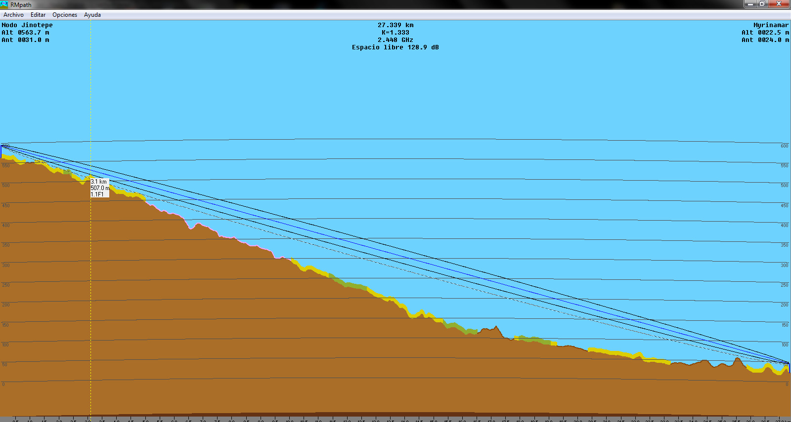

I am attaching the profile link just to provide more detailed info.
