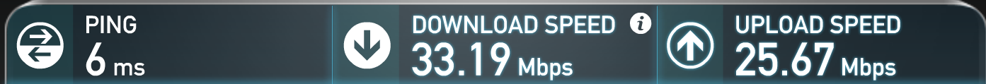

Here is a speedtest.net test from my computer when attached to a bridged/switched port on the RB2011

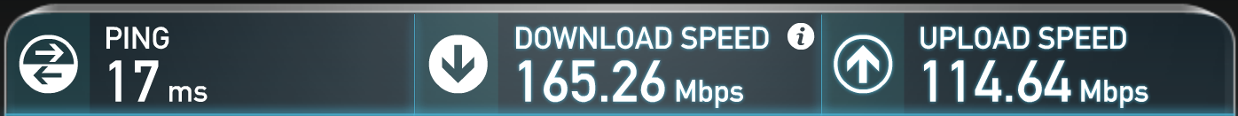

Here is a speedtest.net test from my computer when attached to a port providing DHCP on the RB2011
When the RB2011 is bridged, could one of the other devices connected to the 2011 be acting as a DHCP server and your connection using that device as it’s default gateway instead of the CCR?
Have you tried disabling all interfaces other than the uplink and the one connected to your test router to see if it behaves the same?
Even some other device connected to the 2011 claiming to own a static default gateway IP which is supposed to belong to the CCR could be hijacking your connection. Double check that the ARP entry for the default gateway on your 951 has the right mac address for your CCR.
If it’s not a hijacked default gateway issue, I’m out of ideas.
