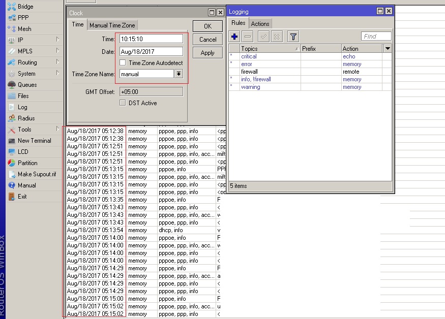

time diffrence between logs and router clock
router OS 6.35 router clock time is correct but in logs not correct Approx 5 hours delay

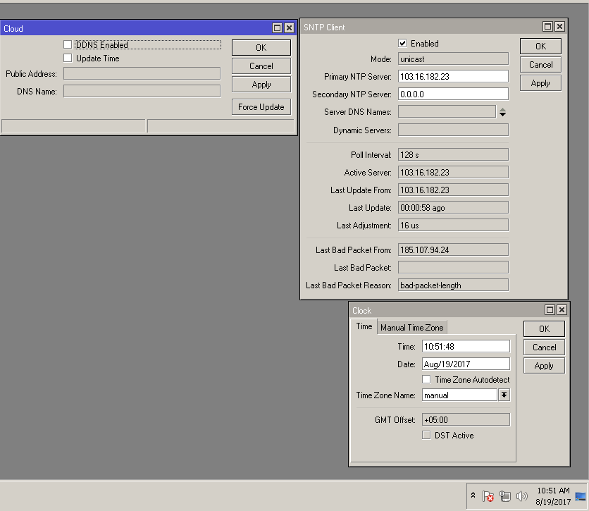

check this
Try selecting one of the predefined timezones instead of manual.
try but no success same position
Strange. No idea, it works fine for me.
A. Please sow |Manual Time Zone" tab content
B. Instead of direct IP value for NTP server it is better to use DNS names eg. 1.pl.pool.ntp.org or jp.pl.pool.ntp.org
C. Seems to be stupid but try to enable/disable/enable or disable/enable/disable procedure for time settings. If ypou have upgraded ROS then maybe current values clasesh somehow with visible settings and Winbox fools us/you
D. Is your public IP belonging to the declared Time Zone?
E. Could you upgrade ROS to newer version? I see e.g. “ntp - fixed ntp server when local-clock used (like usb gps module);” for 6.39
F. Please add info of “Up time”, current time and date to the Winbox toolbar and compare it with NTP client and log data
G. Try to use Winbox on different computer or use WWW access to verify/compare Winbox information.
H. Do you have NTP server installed allong NTP client?
I. is IP of NTP server public one server or ypur own one?
