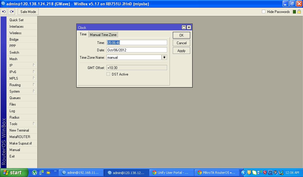

Dear all
Kindly help me to resolve the below issue…
I am using Mikrotik 751 in one of my customer premises …with Userman technology but the problem is time differance in mikrotik router and userman session time …the session time is 5hours less than actual time …
you should do it by user manager always manually. Try this:
User Manager → Customers → select customer “admin” → find “time zone”
here set value +5:00 and click button “save”
