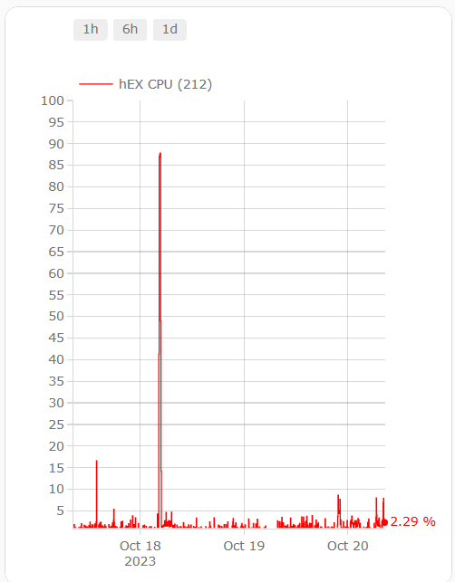

I run Home Assistant with the Mikrotik integration and this is the CPU data. I don’t know it is the equivalent to RouterOS’s “Total” CPU or something else.
So, when looking at your graphs, I see that you had one CPU spike during one single day on the 18th of October at around 5am (guessing from the time scale, if your devices are ntp synchronized). At that time it appears that you had a traffic spike, but on a daily 5 minute average on that day you have 3.5Mbps traffic…

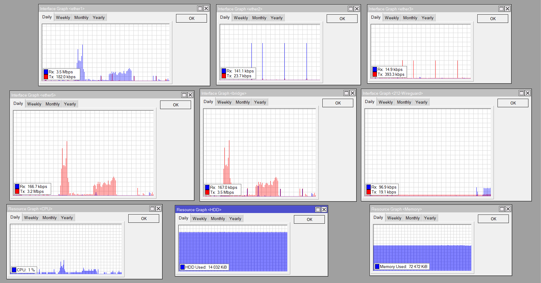

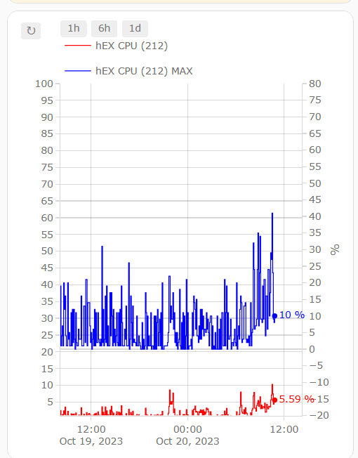

Here’s another graph. The prior was used a 5-minute mean calculation of CPU usage.
This one also has a 5-minute maximum CPU in blue (I moved the scale up for the right-side Y-axis just to keep it readable).

Uh ? Wait a minute … you got an RB5009 for nothing else then Dude ?
SWAP. ASAP.
Hex can also be used as Dude server (heck, RB5009 can take all duties of Hex and still act as Dude server)
Especially when running wireguard, you will benefit from the additional processing power of RB5009 vs Hex.

Wow! That’s true high-tech nerd guilt! I’m honored and grateful – it worked.
I just swapped the RB5009 for the hEX, despite my fears that I’d be spending hours and pulling my hair out (which is why I’ve been “hesitating” – which is a mighty generous word for 6 months of not doing it).
I think I got it working just fine. I basically copied the sections of the hEX export that were needed and didn’t contradict RB5009-specific items (like eth1-8). Changed some IP addresses and boom – it works.
speedtest.com shows about 833mbps down/934 up (no, I don’t know what it was with the hEX).
And my wireguard connections are working also!
It feels faster – and feeling good is what counts, right?

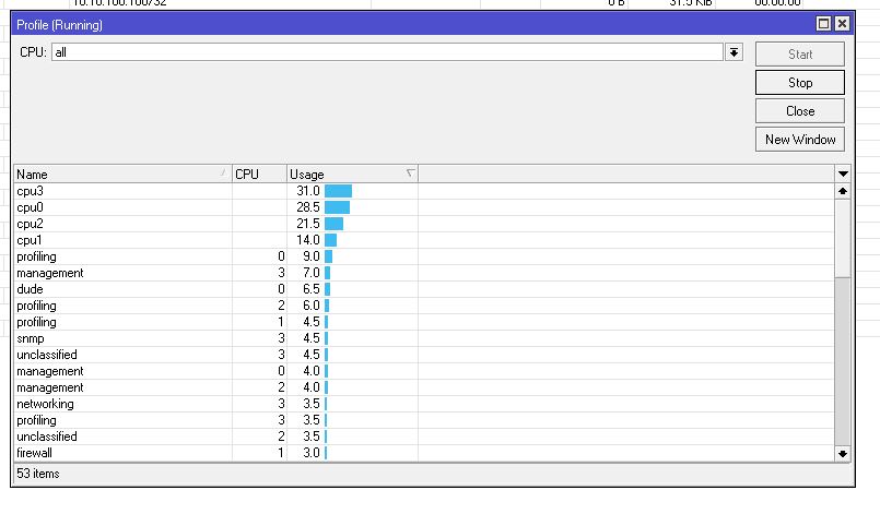

I did not wipe the RB5009 clean, so I still have The Dude running. I wonder if that’s why the Profile all CPU is higher than the hEX:
And, yes, I wear my socks, underwear and t-shirts until the holes in them are too annoying to those around me.

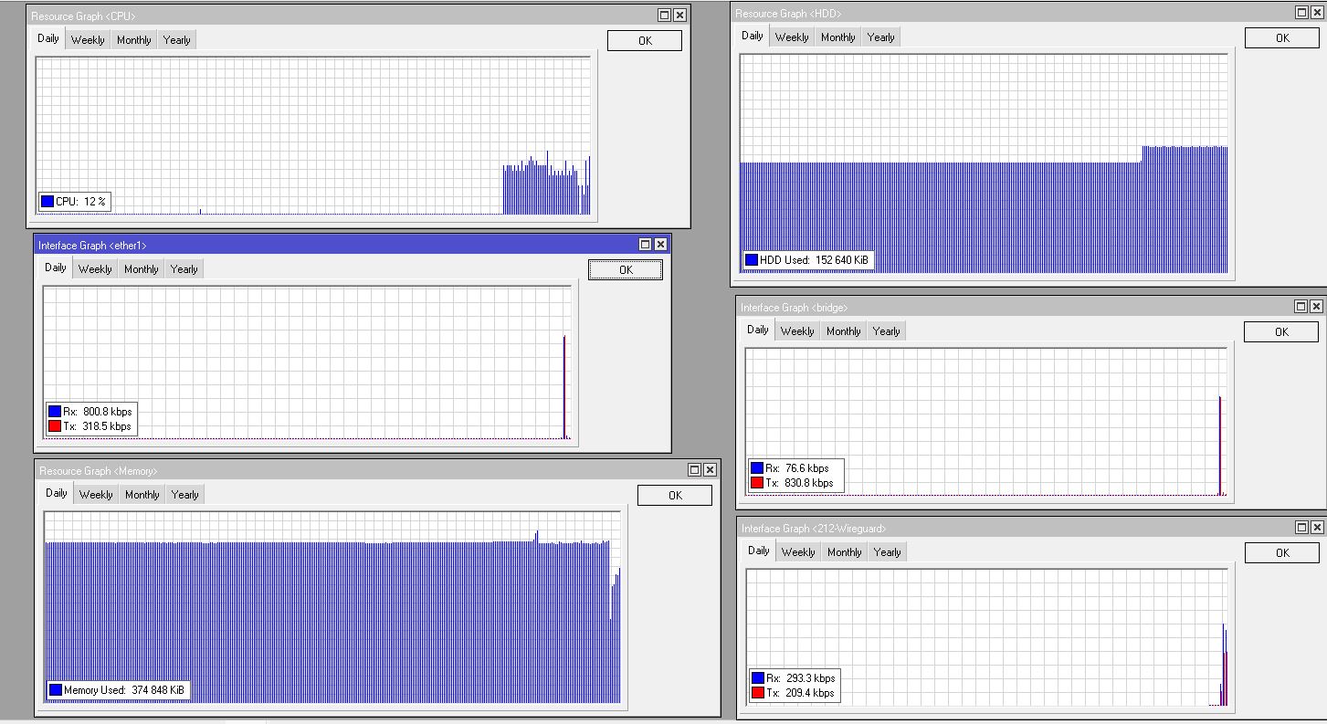

Here’s a bunch of graphs:
Oh, I doubt the hEX get to those speeds with a wireguard connection going at same time.
You can look at System > Profile and see what CPU Dude is using, but unless your monitoring hundreds of hosts at a high frequency, it’s CPU is pretty small generally. I’d leave it on RB5009, keep it simple. Keep the hEX for backup and/or “playing” with config before exposing your demanding user base to novel configurations.

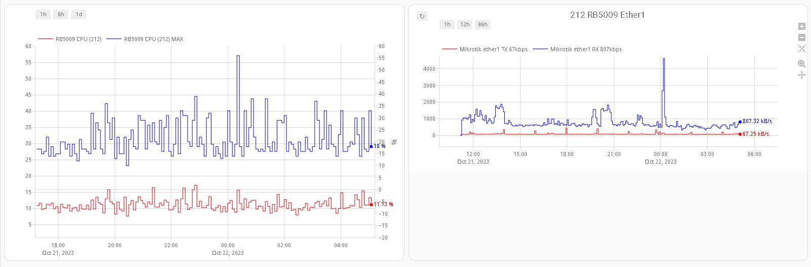

Here’s a 24 hour update.
All is working well. I’ve been unable to identify what is causing the spikes in CPU usage or throughput.
I’m pretty sure the spikes are something automated (i.e., not a user-induced condition). From these graphs, 5 hours ago (midnight local), there was a CPU and a throughput spike, but I was the only person home (the only user) and I was asleep.
I’m not concerned about it – maybe a backup, or an update, or FANG (Facebook, Amazon, Netflix, Google) just getting their daily dump of all my day’s activities/thoughts/communications/etc.

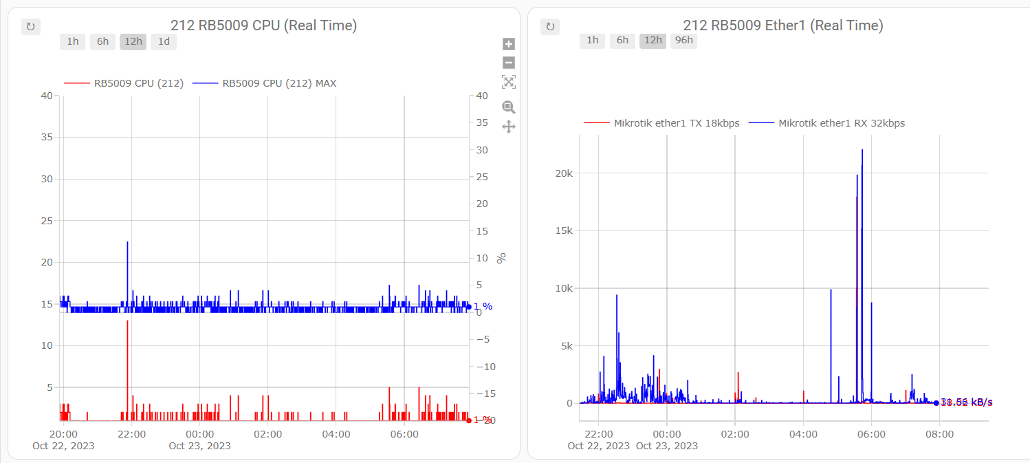

The past 12 hour graphs are below. This is what I’m calling “Real Time,” for lack of a better term, as opposed to 5 minute averages. I think that means the data points are plotted as often as they are provided to Home Assistant.
I disabled The Dude, and the CPU and throughput dropped substantially.
Indeed, other than some short-lived throughput spikes in traffic TO the internet (thank you mkx), both CPU and ether1 throughput is pretty low.
