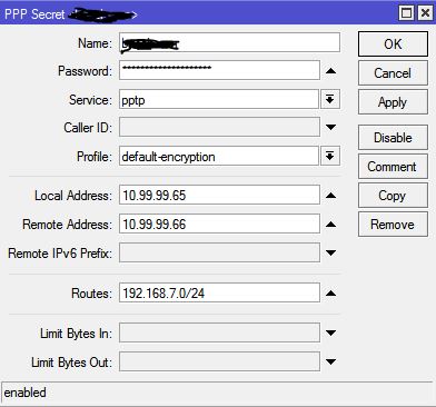

PPP Secret on HOST

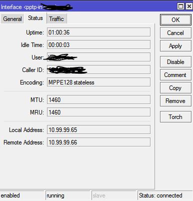

PPTP Server Interface on HOST

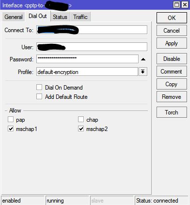

PPTP Client interface 1/2:

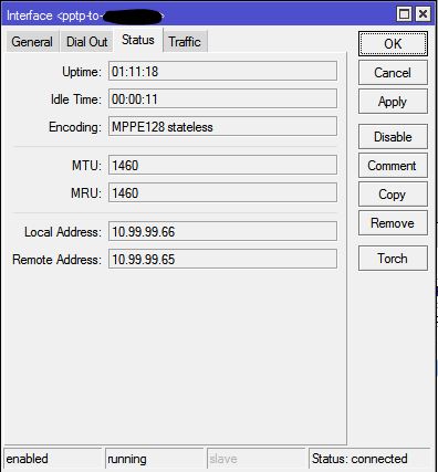

PPTP Client interface 2/2:
