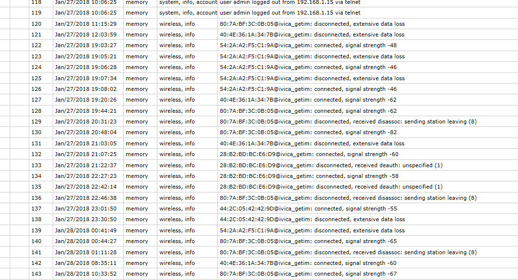

For example this is my HOME, and the client that says extnesive data loos is a TV who doesnt move inch, and as u can see signal is more than powerful(-48-62), still i get random disconnects for all devices at home, Philips TV, HTC phone, ASUS tablet, Asus Laptop ..
Sometimes its ok entire day, sometimes happens few times a day.
I had 2hspn before, now i put one SXT2 lite, and still happens, and i tried all stuff, changing all channels, setting auto, changing to WPA2 only, increases HW retries, timeouts, setting N only mode, chaging 20 only or 20/40mhz,turning WMM On/OFF, multicast helpers, noise immunity settings, various Router OS versions, using pretty much stock configuration with reseted device, u name it, i tried every tip and trick that available on google or this forums for mikrotik..
