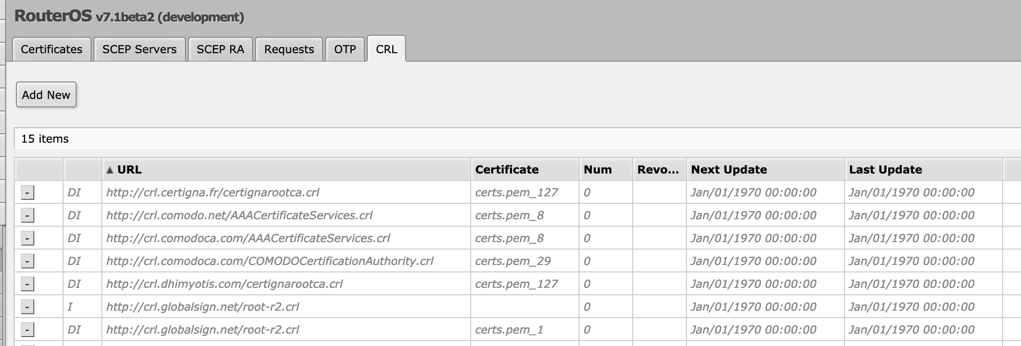

I had already imported CA root certs from here: https://mkcert.org/generate/
[admin@chateau] /certificate> print

That CRL was already in the CRL list but shows up as invalid. I tried re-importing from the URL but it was invalid as well.
CRL seems only be possible for certificates you generate on your Router.
This what I remembered reading your posting: http://forum.mikrotik.com/t/v6-47-1-stable-is-released/141227/56
