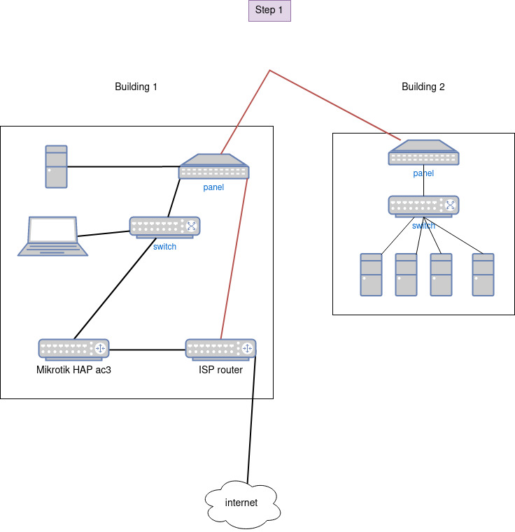

I changed a network management and configuration by adding a mikrotik HAP ac 3 wireless router on a small non-profitable org. First they only have an ISP Box to manage their LAN and WAN, which is basically, an internet modem and router with wired port and wireless access. The LAN is a mix of static and dynamic addresses, by changing ISP they must redo their network. So I added the router to avoid that.
As you can see in the draw below, they have two buildings and the network is connected between 2 path panel. I started by only change the network for the first building. This way people from the second building could use internet without interruption during the settings (red line).
When I finished to configure the mikrotik, I just unplug the wire between the path panel and the ISP Box and plug the path panel with the switch.
I thought everything will be fine as I hadn’t issues during the step 1. I had issues with DHCP which were caused by an hidden zyxel wireless router that I discovered later. The laptop in building 1 didn’t get an IP from mikrotik dhcp range 192.168.88.0/24 but instead an address 192.168.1.0/24. I remove the zyxel and everithing went fine. Notice that the zyxel and ISP Box had the same dhcp adress range 192.168.1.0/24.

I know clients broadcast DCHP requests. So it could be an answer that the fist response is accepted by the client and the zyxel router was the first, even if the request go through a more “long” path. By long I mean distance, we are talking about 2 meters of cable between laptop and mikrotik versus almost 200 meters between laptop and zyxel. But I also mean number of devices, there are one switch versus two. In fact, I am not very confident with my hypothesis of distance, because I know that trafic volume and packet processing could be an answer.
As I first suspected the ISP Box because of DHCP IP range and I didn’t know the zyxel was on the network, I did a try. I connected the laptop to the mikrotik router with wifi. In this way, the mikrotik is the first device to receive the broadcast DHCP request. I was surprised by getting another 192.168.1.0/24 address. I thought it was a sort of caching of my client, I restarted the laptop. Same result :slight_smile:
So now everything is fine, we also let the zyxel but only as an wifi acces point without DHCP server. But I still don’t understand how it was possible, mainly when I was connected in wifi. If someone could have a clarification ?

So when DHCP client requests a lease (it’s a 4-way handshake) and it previously had interface provisioned via DHCP (and it remembers previous settings), it includes old IP address in initial DHCP discover packet. When DHCP server receives such packet, it can either offer a DHCP lease with indicated address or reject indicated address. In general if there are multiple DHCP servers in some L2 broadcast domain, all will handle DHCP request (obviously with slightly different timing and possibly with different answers) and it’s up to DHCP client to accept answer from any of them. Most of times, when answers are equally acceptable, client accepts response which is received first. But in case that first answer is negative and later answer positive, client is free to use the positive answer.

@mkx : Thank you very much. I expected to learn more about DHCP and you help me to better understand it. The authoritative option is set to yes. Even with that I would say the scenario was not the same. During step 1, the laptop got a lease from the mikrotik DHCP server with 192.168.88.0/24. Based on your explanations, in step 2 the request was sent within this IP range to get the same lease. But I got one from Zyxel on range 192.168.1.0/24.

According to wikipedia article (which includes quite some details), when acquiring DHCP lease DHCP client always sends packets to broadcast MAC address … even if it includes previously used IP address as optional data (in DHCP discover packet). Same for DHCP request (which acts as “confirmation” step), client also sends it to broadcast address. DHCP server always uses client’s MAC address as destination making it unicast ethernet frame.
Regarding renewal (where client believes it already has valid IP address in current subnet), it may (but doesn’t have to) use unicast IP/UDP communication with DHCP server which issued original lease … and in this case rogue DHCP server usually doesn’t interfere (because it hopefully won’t even receive that unicast traffic).
The problem with rogue DHCP servers, as observed by @liochan, is that they pretend to be authoritative (same as Mikrotik’s default setting) and can interfere with ongoing communication with another DHCP server also in second stage (DHCP Request / DHCP Ack) because client’s packets will reach them.
