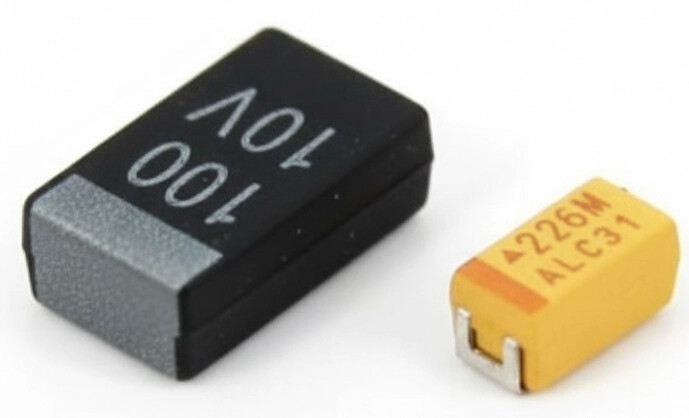

The biggish black square one with two terminals between the RJ45 and the processor might be a tantalum one, of the kind seen here:
https://jlcpcb.com/blog/read-smd-capacitor-code
on the left:

They are probably using solid polymer capacitors in this case.
Yep, they are the same thing, AFAIK solid polymer are tantalum capacitors.
