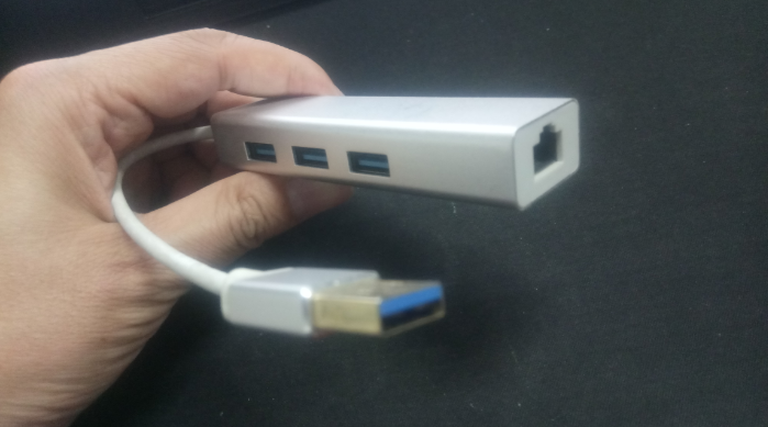

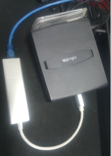

I had a whim today, this router has a USB2.0 interface, will it support a USB Gigabit network card? So I found out a spare USB3.0 Gigabit network card (it is tested to be Gigabit). The USB port of the router is 2.0, and the speed is up to 480M. What will happen if this network card is plugged in?
It looks like the picture below:

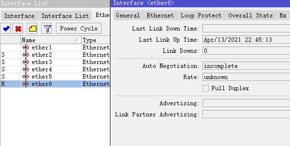

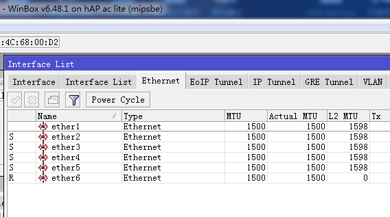

The router even recognized the USB network card and added an ether6 interface. This is the rhythm to work.

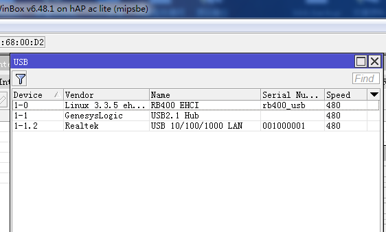

Looked at the USB information, it looks like this:
There are some problems with the speed display, but after the network card is inserted into the network cable, it can work:

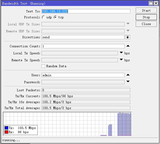

What about the test situation? Use the router’s own speedtest tool to test the speed of another gigabit router. In the receiving direction, the udp method can basically reach 300M; there are probably some problems when sending, the udp rate is not high, but the tcp sending rate can reach 100M . Because speedtest itself occupies a lot of CPU, I don’t know where it gets stuck when sending UDP data.

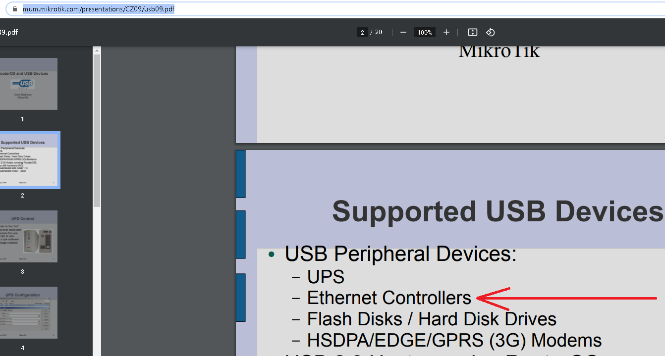

Hmmm - it looks like ROS does support USB Ethernet Controllers ( __
never had a reason to check[/i] )
