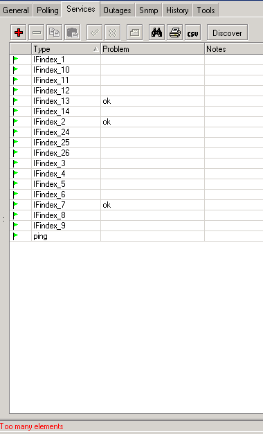

Can you help me with this error?
When I create a device manually and then click the “Discover” button to discover the services it has (interfaces, probes, etc…) I get the following error/warning in red letters at the bottom: “too many elements”

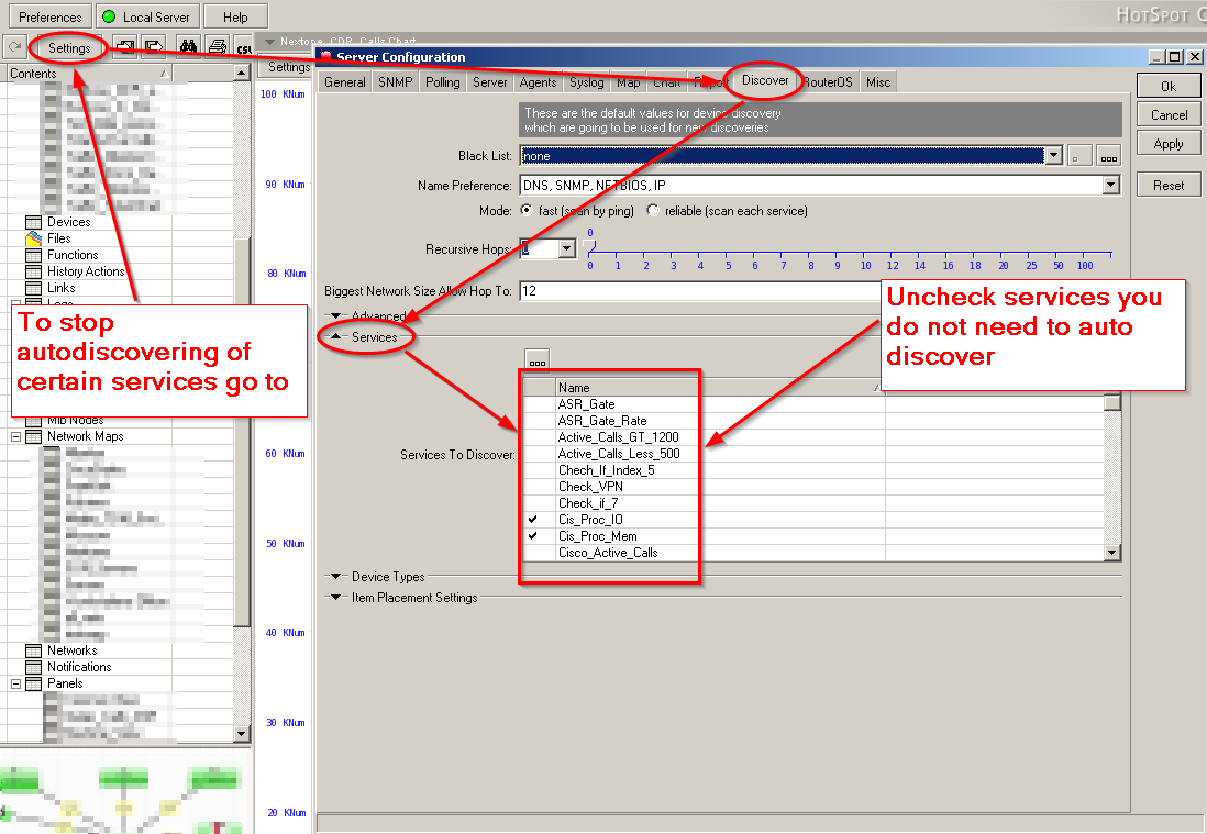

Do you rely need all those services IFindex_1… IFindex_26 to be autodiscovered?
If not - disable autodiscovering for those services and this should solve the problem.

You can stop auto discovering of services when you press discover button on the device properties, have a look at the picture
