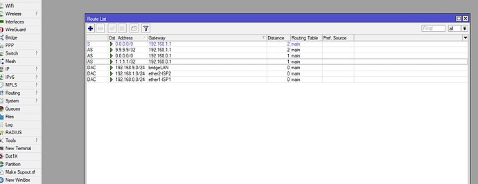

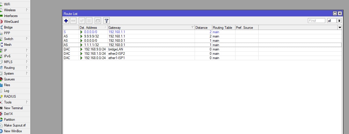

This is how Ip/Routes looks like in my case. I suppose one of AS should be removed
Yes, that is normal.
You have a AS route for canary address 9.9.9.9 via 192.168.1.1.
The corresponding 0.0.0.0 route is S because of higher distance 2.
Then you have an AS route for canary address 1.1.1.1 via 192.168.0.1.
The corresponding 0.0.0.0 route is also AS because it has (lower) distance 1.
Right now you have worklng connections through BOTH 192.168.1.1 and 192.168.0.1.
Ther point is about what changes when you physically disconnect:
  1. the 192.168.0.1 device from the Mikrotik
  2. the 192.168.1.1 device from the Mikrotik
  3. the 192.168.0.1 from the whatever is upstream
  4. the 192.168.1.1 from the whatever is upstream
