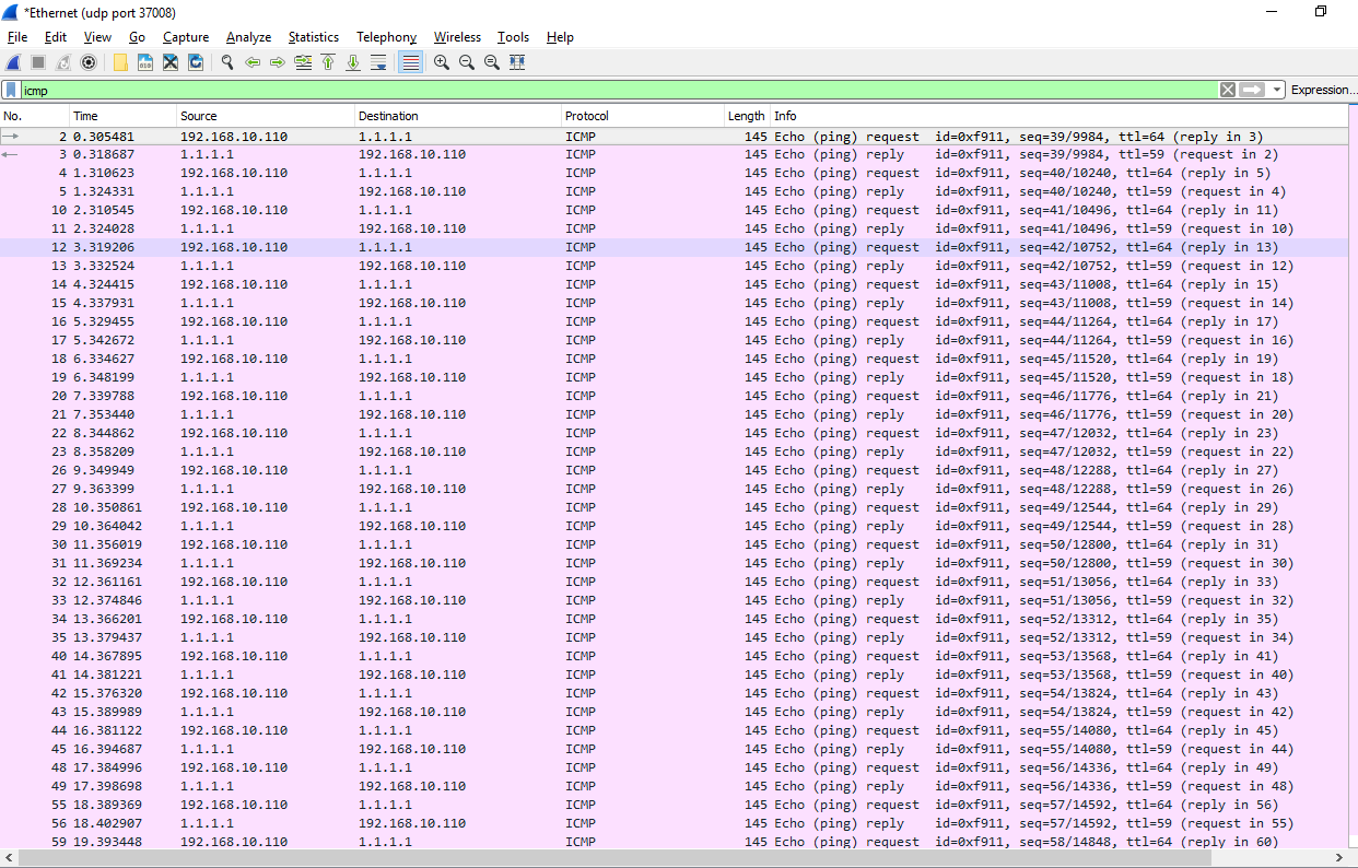

You may try to use “udp port 37008” as a capture filter in Wireshark, it works for me.
And it’s also a good idea to filter stream on mikrotik’s side at least down to a certain interface as poor Wireshark
gets confused by the same packets captured several times.
Capture filter in Wireshark doesn’t change the fact that RouterOS is sending packets to closed port. So if target computer sends back “port unreachable” and you’re capturing traffic on same interface where it’s connected, you will see it in captured data (if there’s not a filter that excludes it).
But it seems that so far nobody cared about proper solution, i.e. something that would actually receive those packets and pass them to Wireshark. I don’t know if I’m just using wrong keywords for searching, but I found nothing.
I do not have these “port unreachable” icmp packets in my capture (see below).

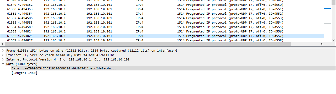

  2. Filter-stream very much works for me as without it enabled I get ~170 Mbps of some (fragmented ?) UDP packets captured out of the blue, as on the screenshot below. And it’s also cancels out those “port unreachable” packets when I’ve tested on macOS, but you of course still see them captured locally if do not set capture filter in Wireshark, and you can always tuck them away with “TZSP” view filter.

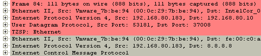

The main problem is that capturing TZSP with Wireshark this way is simply wrong. What you want to see are packets from router, exactly as the router had them, but it’s not what you’re getting:
The whole red part shouldn’t be there, it’s TZSP wrapping and you’re not intersted in that. It’s confusing for both user and sometimes also for Wireshark, it seems. But it doesn’t look like anyone implemented proper solution yet (something actually receiving TZSP packets and unwrapping originals).

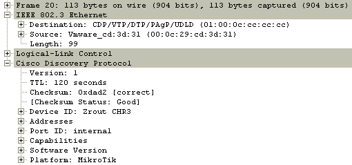

Once installed, it will add another interface to Wireshark:
If you select it and start capture, Wireshark will start the script and it will listen on udp/37008 (you may need to allow it in firewall) and will pass all received packets to Wireshark. Here is an example of router sending CDP packet (notice that it’s the original packet, as was on the router, no TZSP wrapping):

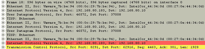

But that’s not really all, there’s one more thing. It seems that there might be a bug in RouterOS. The option to filter stream (to not capture TZSP packets sent by router) doesn’t seem to always work. With small packets, everything is ok. But large packets don’t fit in one TZSP packet and need to be sent fragmented. And then something like this happens, router captures own TZSP packets (it’s captured using regular Wireshark capture on ethernet interface):
