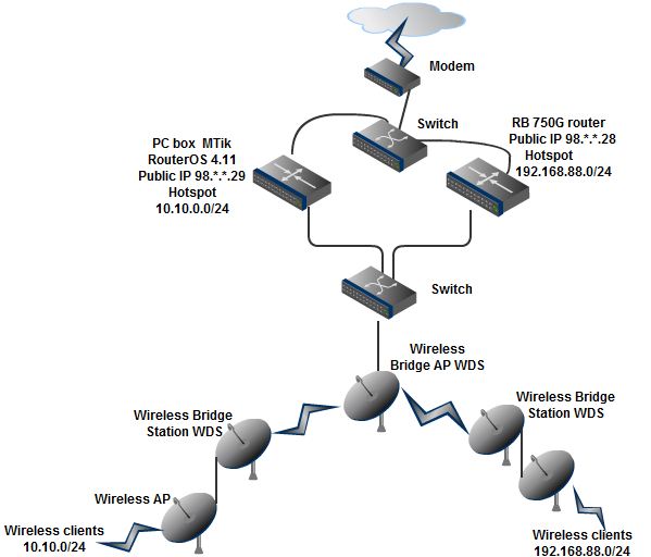

Topo question 2 routers 2 ip's 1 AP
Will this setup work?
Can I eliminate either switch?
And Use 1 router to pass the 2nd Public IP to 2nd router?
Will it work with 1 AP interfacing to 2 routers each with own hotspot?
Can this be done with one router?
Depends. You can do more than one Hotspot per router, yes, so you could do just one router. No different from running just one. If the ISP uses static IPs just assign them both to the outside interface and instead of masquerade use src-nat with the appropriate to-address to NAT the two Hotspot networks to different IPs, if you need to. Otherwise just use one IP for both. You can use just one switch (even if you keep two routers) by getting something that can do VLANs (802.1q). There’s cheap dot1q gear around. Each Hotspot network and potentially each WAN uplink if you use two routers gets its own VLAN.
Maybe get yourself a CCNA book or something. Ignore the Cisco specific parts and study just the background material. While not completely trivial these are fairly basic things to understand.

Budget constraints aren’t fun. Still I think VLANs are the way to go. You can pick up a used Dell PowerConnect for $20 and use just one switch for everything, there are other options. Hell, the 250GS from Mikrotik might (should) work for this. As long as the APs can do VLANs and support multiple SSIDs you can do both networks on each AP.
But if you really need to balance things, do just one network per AP and keep an eye on things, and move the APs over to the other network as one network has too many users. Try to plan out the area and where people will be so you can minimize that. It’s absolutely doable, though.
Given your constraints of course you cannot eliminate either router.

I won’t need 2 or more SSID’s per AP.
The AP’s are physically @1 mile apart.
So at the terminal end each wireless AP would be given their own respective SSID.
So, one SSID will work off of the routerboard lic. 4. The other SSID would work off of the PC box with Lic. 5.
But, now I see the benefits of what you were suggesting with the vlan’s and doing multiple SSID’s per AP. And being able to use just one routerOS.
