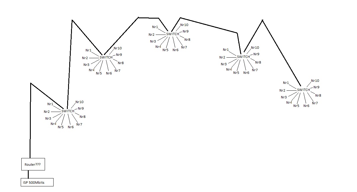

Is Anyone have a good tip on building an “ISP” topology for a Camp yard with around 50 Cottages.
I Will have a Router of some kind in the Reception, and then a copper Cat6 to 5 places/“Islands” in daisy chain. So it will be a 24 port SwOS switch in every Island and from there a Cat.6 copper to every cottage.
Every Cottage will have some kind of minirouter for example Hap aclite, and must be isolated to each other to have there own network.
Will it work with an RB760iGS as “headrouter”, and then set an adress scope for example 10.0.0.1/24 and then set static IP on every router in cottage? or is it too bad hardware to fix the bandwith? I will set Simple queues on every IP to Limit maximum bandwith to 30 Mbit was my thoughts.
Or is there any other kind of simple way to handle this?!
Or do I have to have VLANs for this setup?

You really should build a ring topology by connecting the last cottage switch back to the router. This way you have some redundancy for your “backbone”. Of course you have to run some kind of dynamic routing protocol to make good use of it and prevent loops. For layer 2 infrastructure this would be (R/M)STP, for layer 3 I suggest OSPF.

Cat.6 is buried…I will use existing cat6 cables from a earlier installation of WiFi outdoor access points and make them the Cabins/Islands with switch instead.
