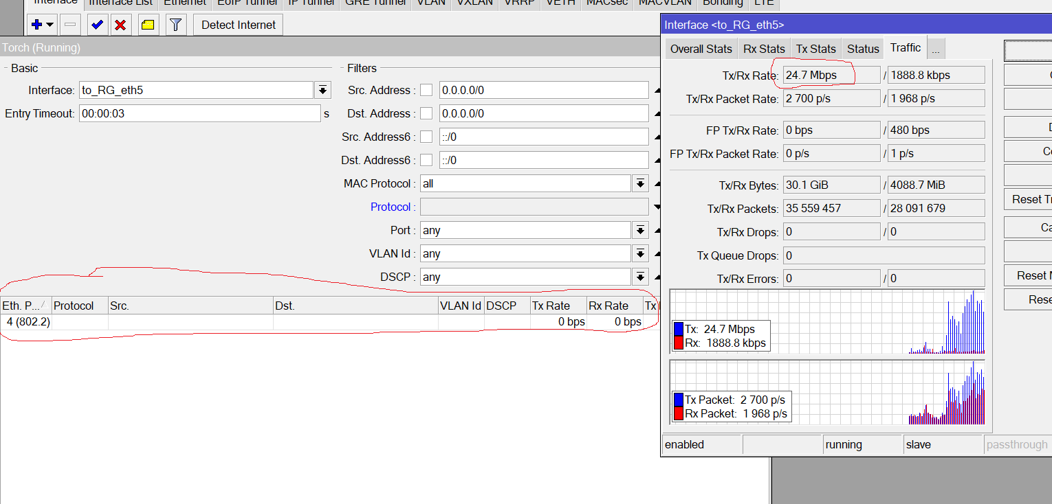

Torch not capture the traffic
When i see tx/rx rate on the interface i can see the traffic is more than 20Mbps, but when i try to see the detail using torch why the traffic is not captured?
Dont you use Fastrack in Firewall rules?
Was was in “Protocol” before you cleared it? see how that is blue means something is changed but not applied. Apply that then stop and start torch.
in protocol also use “any” and for the time torch is running, disable fast-tracking
Thank you for the post. Solved my problem too.
If interface is member of bridge, you have to disable Hardware Offload in Bridge → Ports → General (WinBox)
How we can disable hardware offloading for wireless interface since the interface added dynamically to the bridge?
