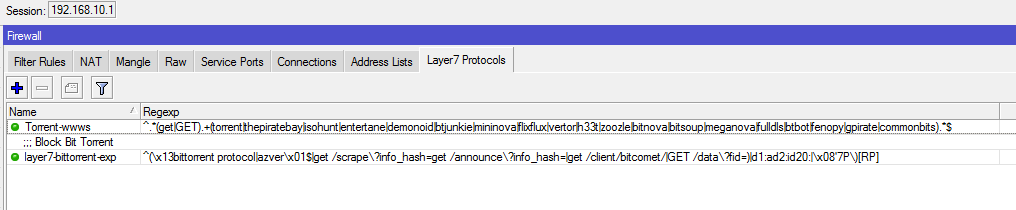

/ip firewall layer7-protocol
add comment=“Block Bit Torrent” name=layer7-bittorrent-exp regexp=“^(\x13bitt
orrent protocol|azver\x01$|get /scrape\?info_hash=get /announce\?inf
o_hash=|get /client/bitcomet/|GET /data\?fid=)|d1:ad2:id20:|\x08’7P\)[
RP]”

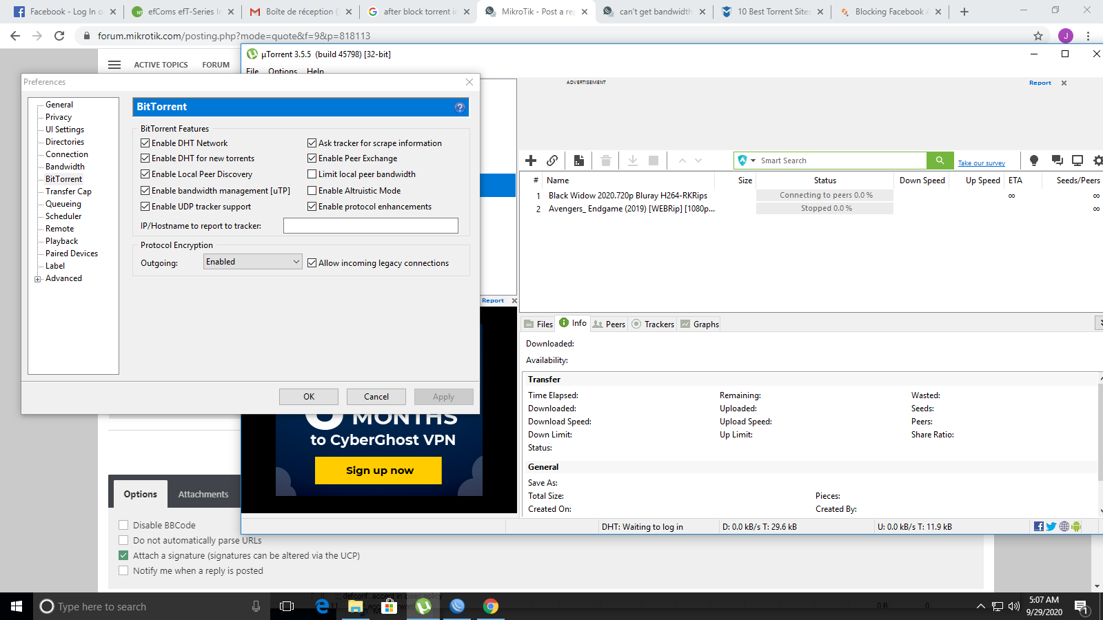

Im uTorrent
Options->Prefences->BitTorrent-Protocol Encryption set it to Enabled, then test if your rule still blocks it.
I don’t know how but it is still blocking torrent after i enabled BitTorrent-Protocol Encryption.

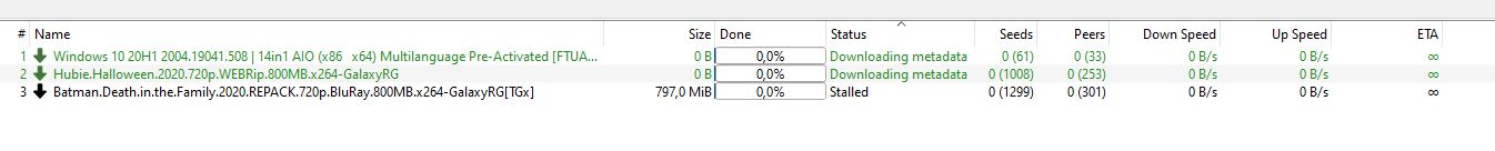

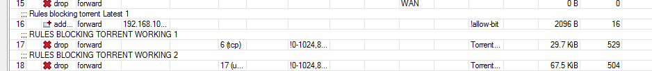

rules are working for me also. i try to download various torrents with qbittorrent and they dont start. “force encryption” is enabled in qbittorrent options.
just a small remark. in second rule you have to change subnet to match your setup. the photo is after one hour trying to download random torrents.
