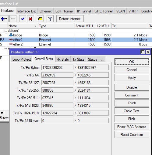

Thanks for response is this what you mean:
I dont really understand what it means though. I’m looked for a total data figure in case I am exceeding my ISP allowance.
Appreciate advice

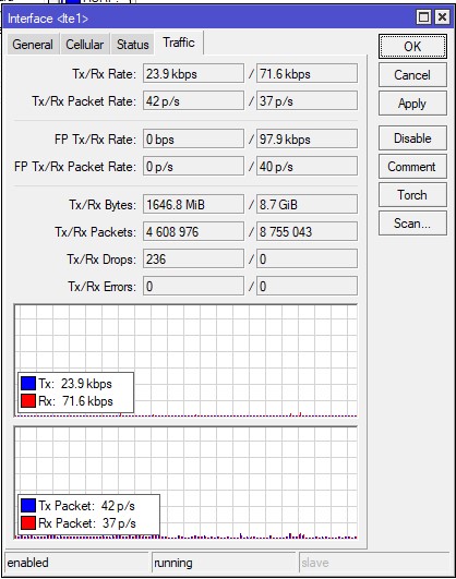

Traffic tab.
Little to the right.
It’s a lot to the right
That looks exactly what I’m looking for. Thanks so much.

HI The Traffic Tab is pretty much doing what I was looking for but just need clarity in understanding it. I assume its traffic from last restart of interface?
Looking at the data I believe the information for “total data used” (as I am considering my data plan limit) is the 5th row of data, Tx/Rx Bytes? the left figure gives me I assume a transmitted data figure and the figure on the right is a received data figure - this im sure is basic stuff but I’m looking for a total GB used - do I therefore have to add the two up & translate MiB + GiB to the equivalent Gigabyte amount? Ideally is there a place I can simply see how much total data i’ve used?

Since last restart of the whole device.
As far as I know, there is no persistent total data counter, which is frustrating. I would like to see this.
Ok thanks. That’s really what I was looking for. Cheers.
