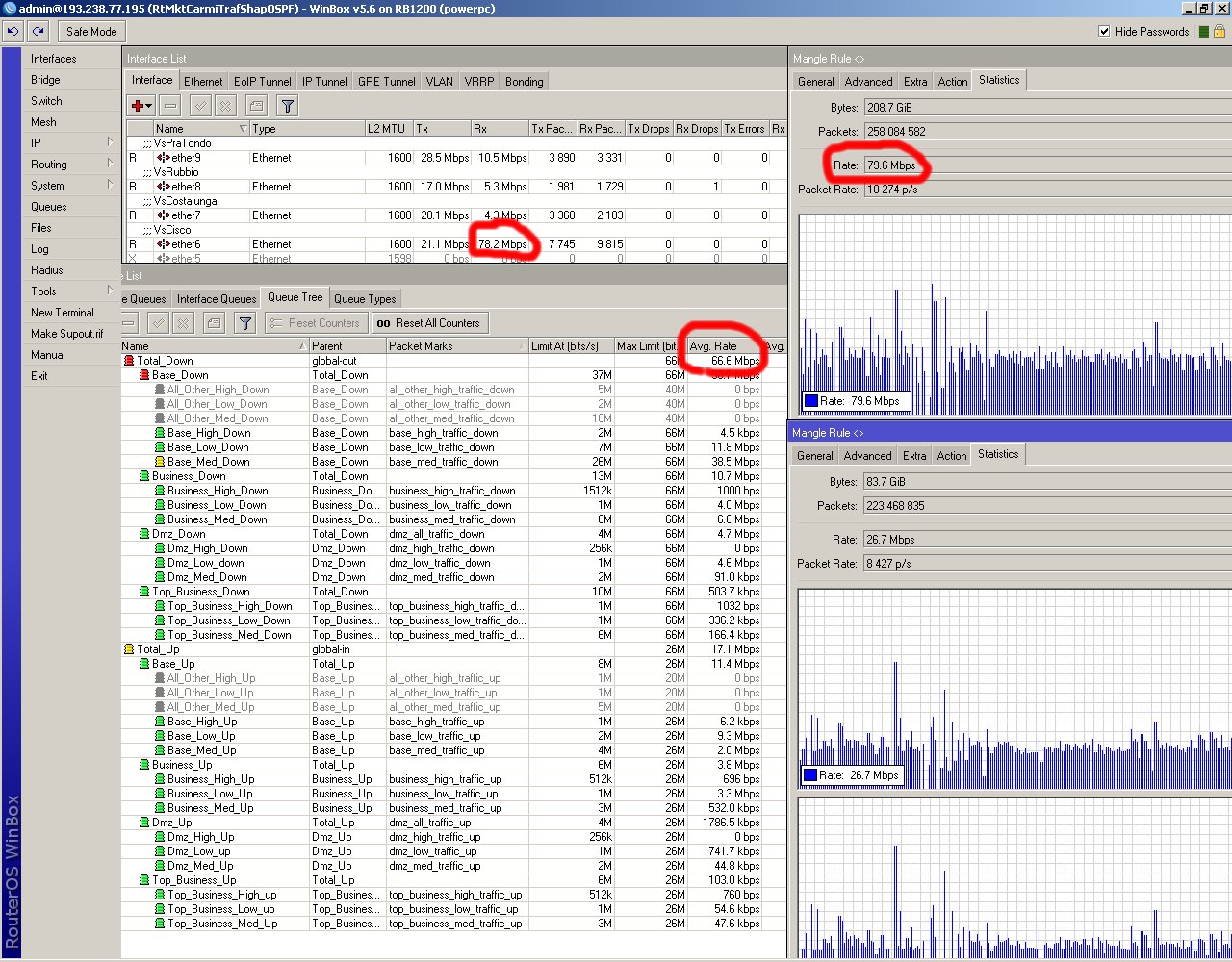

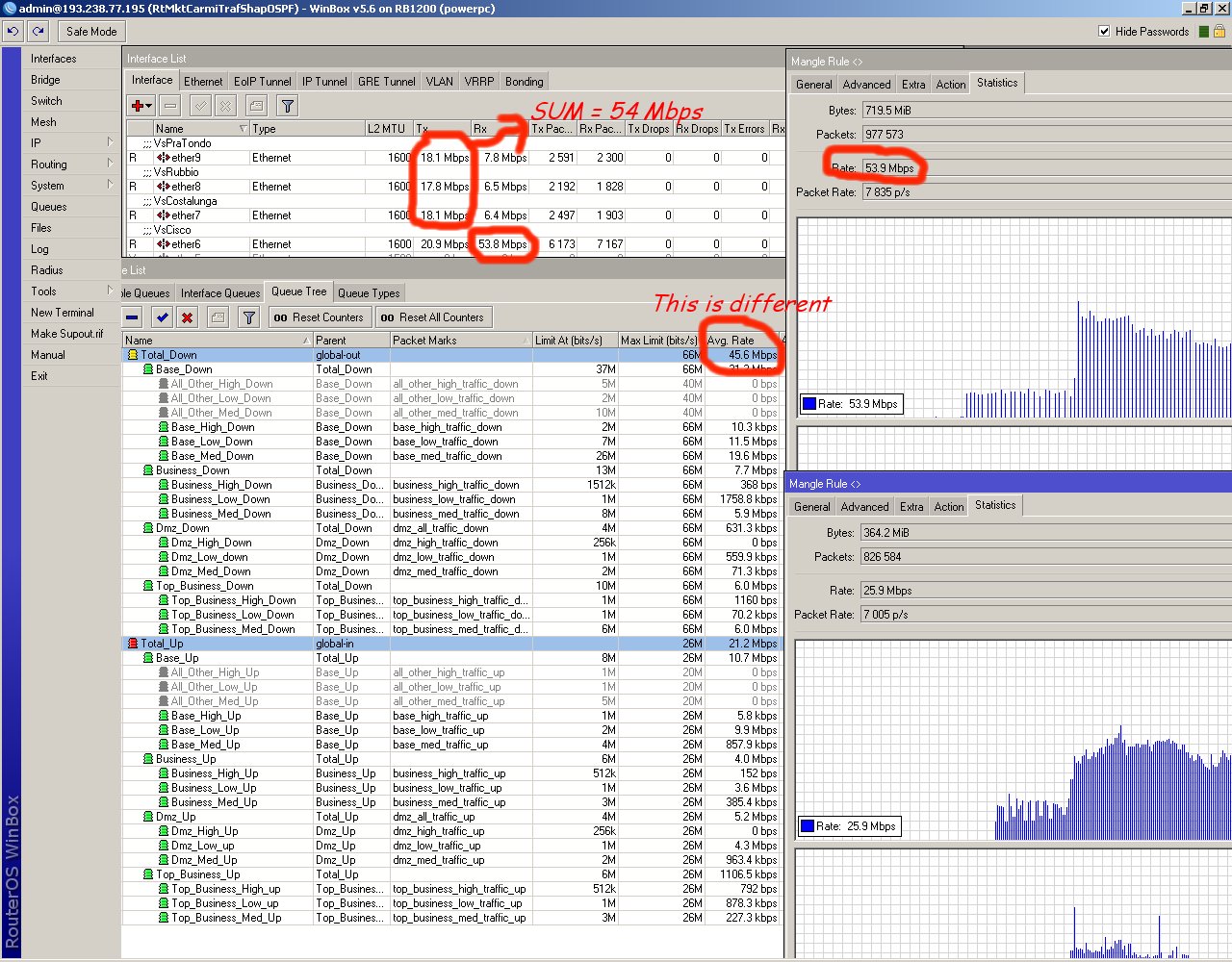

Dear Guys!
I have Mikrotik router with one port linked to public internet connection and other three ports linked to my networks.
On this router I have configured traffic shaping (not transparent) with mangle rules with packet-mark, and queue-tree.
All is working but I don’t understand why Avg Rate of queue “total down” is not equal of RX Rate of public internet ethernet port and why Avg Rate of queue “total up” is not equal of TX Rate of public internet ethernet port.
You could see attachment for more details
Thank you in advance for help
Best regards

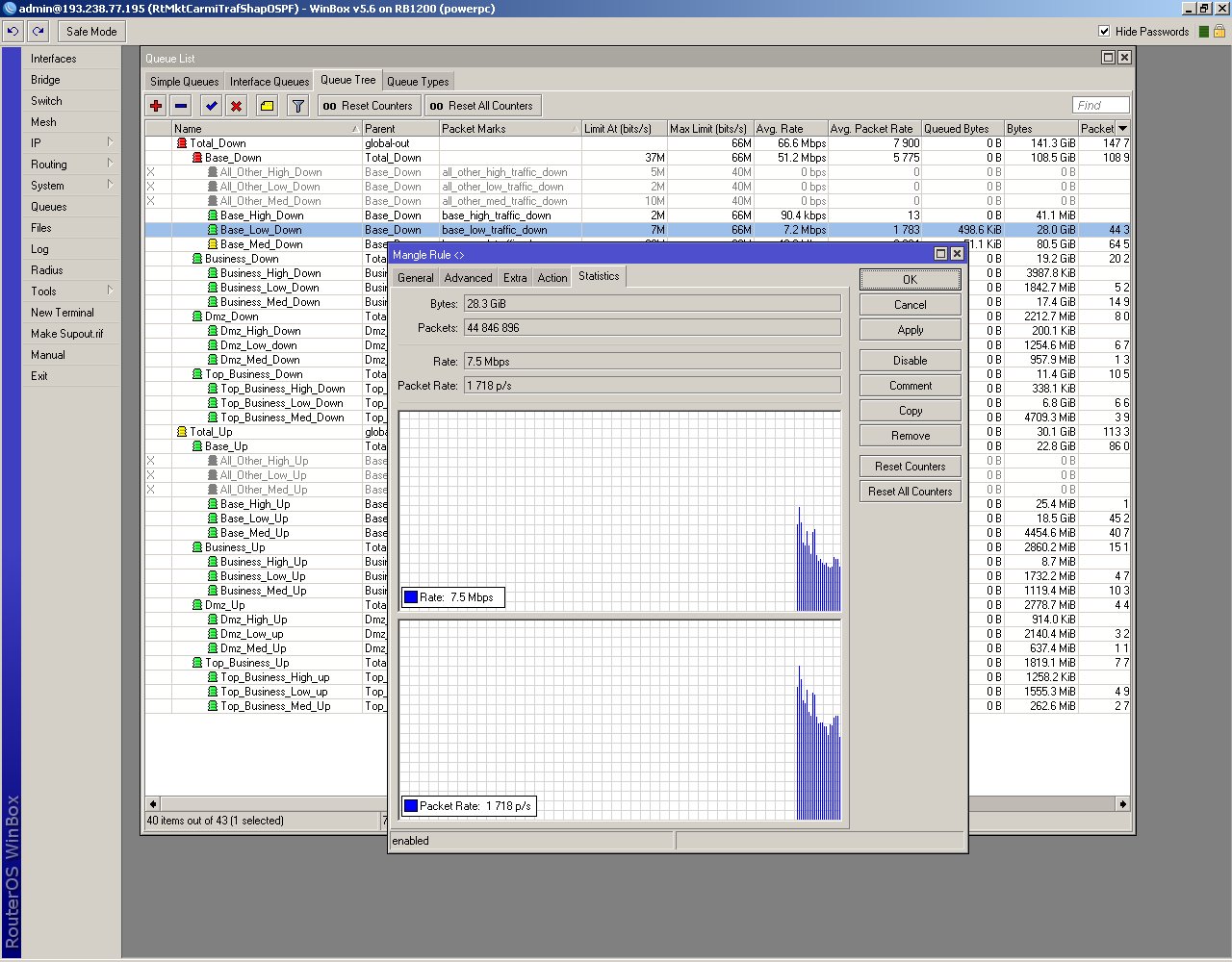

Mangle statistics will show you RealTime traffic, but Queue Tree statistics show an average.

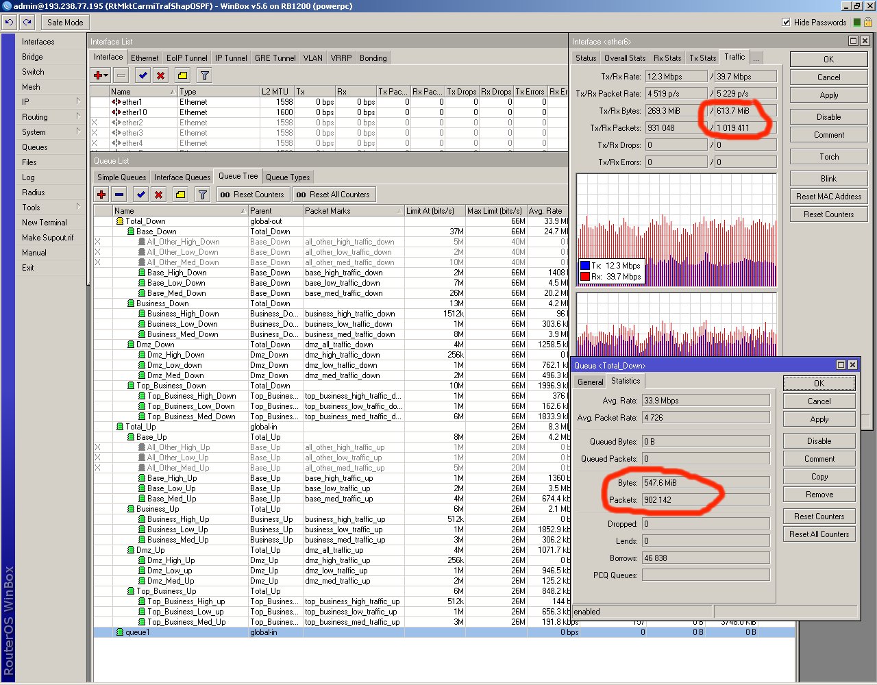

I check also, on statistics of total_queue and public ether, packets un bytes and they are different when instead I think they were equal: why?

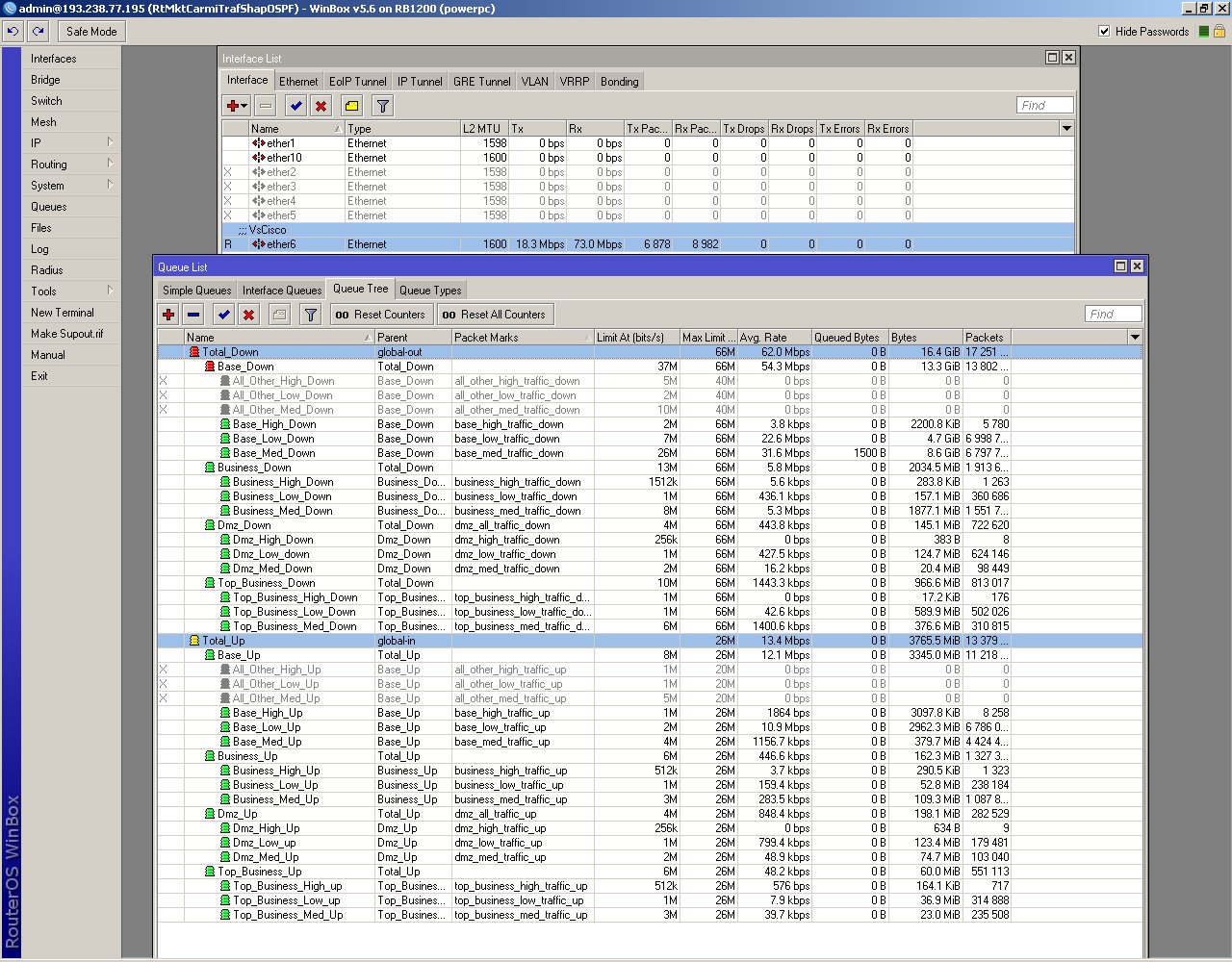

In my situation problem is different: ethernet packets and rate are bigger than total_queue packets and rate (see last image) and so I would know why.

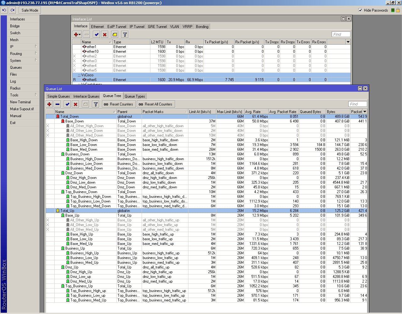

I have smaller traffic on queue than on WAN interface (eth6), instead traffic on WAN interface is equal of traffic on LAN interface… so for me there is some problem on queue because also mangle traffic is equal of WAN and LAN traffic.

In this moment (see image below) queue average rate is 66,6 Mb and current rate (ethernet and mangle) is about 80 Mbps.
On queue tree I set max limit of download queue at 66 Mbps, and so I think to see only 66 Mbps on ethernet RX rate and not 80 Mbps…
For me there is some problem on queue tree, or could you explain me why there is this difference?
