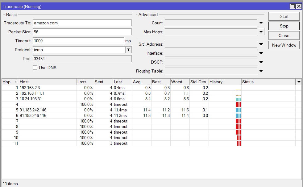

thank you for reply

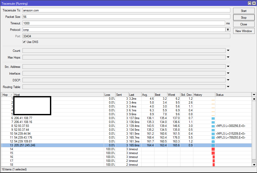

the thing is I can reach the website correctly without any issues but on the Mikrotik (winbox) when I make a traceroute it gives me 100% loss(last 5 hops there is no answer Like the picture that I sent I tried winMTR it worked and gave me 0% loss packet. And as you said if the routers are configured to not answer can I reach the website?
on winbox traceroute result 100% loss packet
on winMTR 0% loss packet
my website is reachable but the result on Winbox gives me 100% packet loss !!
(Note: I do a traceroute for a certain website ,there is no firewall rules to block ICMP traffic)
Ahem … Traceroute in Winbox, is actually Traceroute of the RouterOS with start and output in WinBox.
Could also be started from “Terminal”, or Webfig
And it seems that the RouterOS by default gives up early. After 5 timeouts? Or limit number of Hops?
http://forum.mikrotik.com/t/why-tool-traceroute-limited-to-14-hops/153581/1
Force the number of Max Hops (via Winbox, Terminal (CLI) or Webfig), and see if it gets any further.
PC’s tend to have Max Hops of 32.

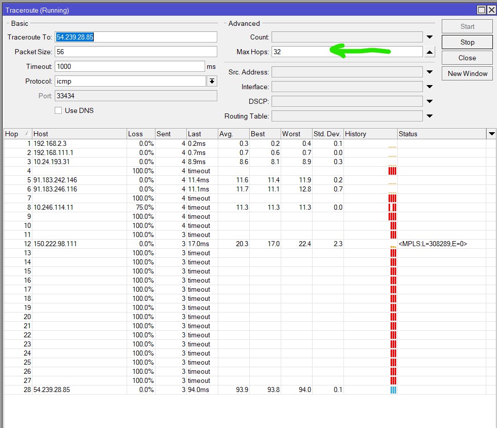

I increased the Max hops to 50 the same as well and the host is empty (no reply ) as you see after hop 15 to 50 no reply
50 hops … that’s far away. Might hit the 1000ms time-out setting.
Also happens when there is a loop somewhere … even my 28 was already a very very long path
