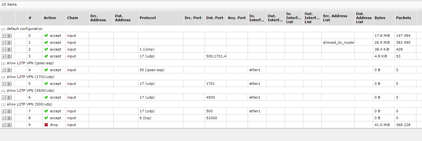

Firewall settings below with my excesise :slight_smile:
when i disable “drop” has no impact on this

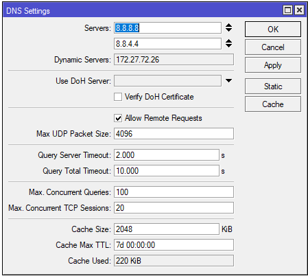

Thx for your answer but what I should do now? and how of course where I be able to check translation DNS?
If it is this thing with dns, you can test (and fix it) by giving different dns servers to this device. Either manually, or add special config for it in dhcp server. Give it static lease and then own config:

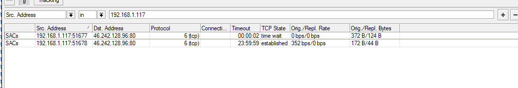

messeges in log’s as below
I try to put the Google DNS
try to add many different addresses but without result, when the device (wiznet) not established the internet connection then it restarts automatically
e.g i use addres IP my mobile phone and use this addres as a static for wiznet devices and does not working.
