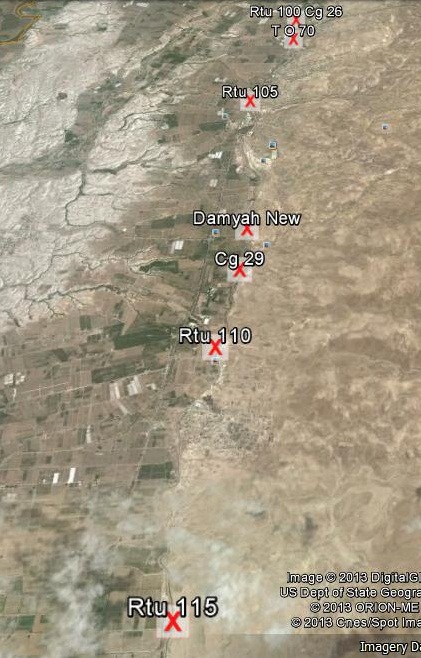

I am designing a wireless communication system for about 17 RTU’s, the RTU’s lies on one line so each rtu will send its data and the previous rtu data to the next one and finally to the monitoring center. the distance between each 2 rtu’s is approx 2-5 KM
the data for each rtu is some control (PLC) points and one video stream from a cctv camera.
I am planning to use RB433 with 2 R52Hn connected to 4 GD5W antennas(2 Tx, 2 Rx), but i could not find any details on mikrotik products manuals about the speed of this combination, the max traffic and the distances that can be achieved.
