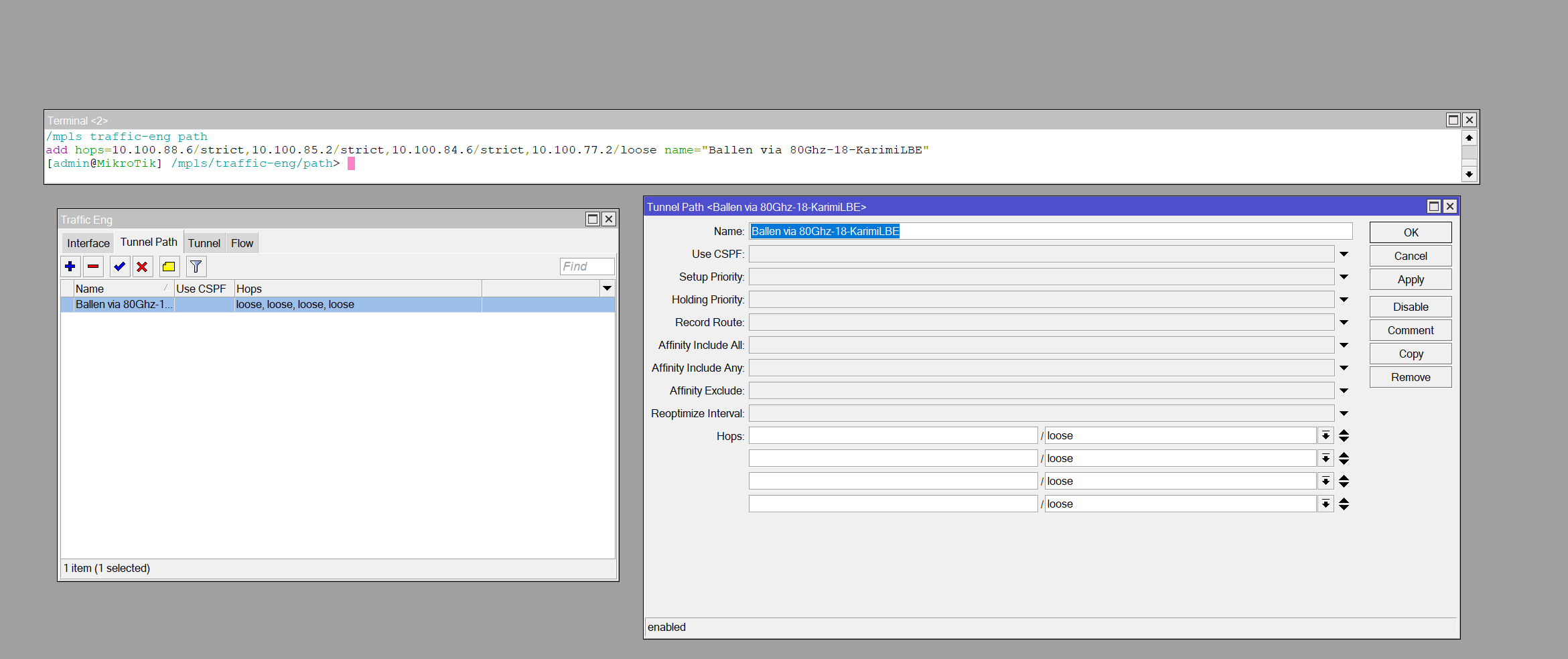

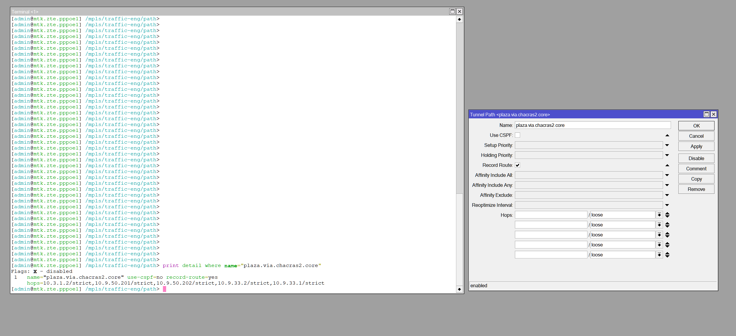

There is a bug with winbox (tested on latest 3.37) causing the hops not to be displayed or set correctly when using the UI, as seen on the image below.
Setting the hops via cli works just fine.
This is what is causing the issues the person above was pointing out.

Thank you for this post/thread. Three months later this bug is still present in v7.7b8 (WinBox 3.3.764bit). CLI only for now. Any changes attempted in winbox will corrupt the configuration.
