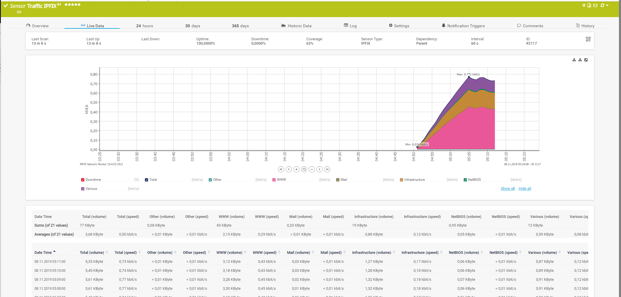

I try to get a nice overview of my network traffic. I actual use a RBD52G-5HacD2HnD with RouterOS v6.45.7 (stable) and have Traffic Flow IPFIX setup to send to PRTG Monitor.
It seems the transferred Data (total MB) looks correct but the bandwidth usage is total incorrect, i always see values below 1kbit/s.
Example of the Traffic Log is attached (Streams Sensor 2117)
Example of bandwidth usage (Anmerkung…png)
I tried using Version 5 and 9 as well, but there i even get 0 kbit/s.
Is mabye PRTG Monitor not able to get correct analysis or is there something i should change on the mikrotik?

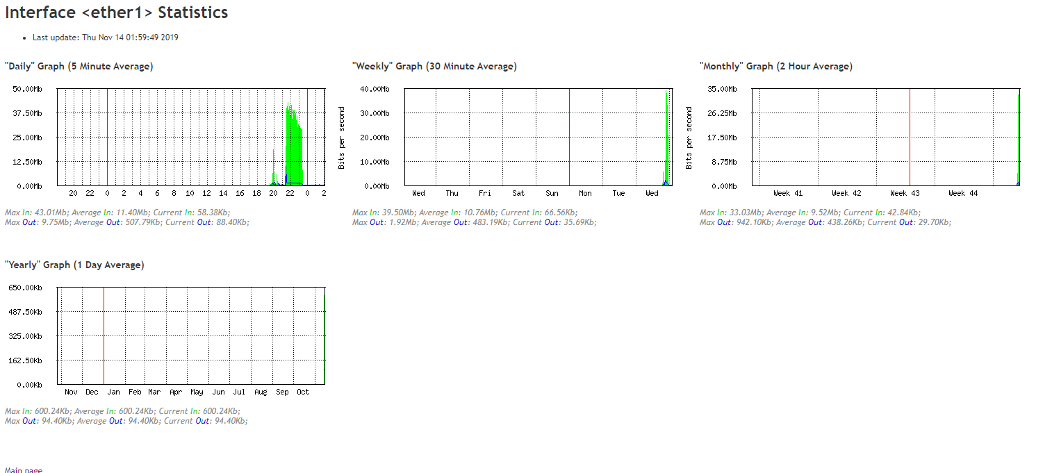

No, sadly not, but at the moment i use the built in graphs, to show me the traffic:
They are configured here: IPmikrotik/webfig/#Tools:Graphing
and can viewed here: ipmiktorik/graphs
