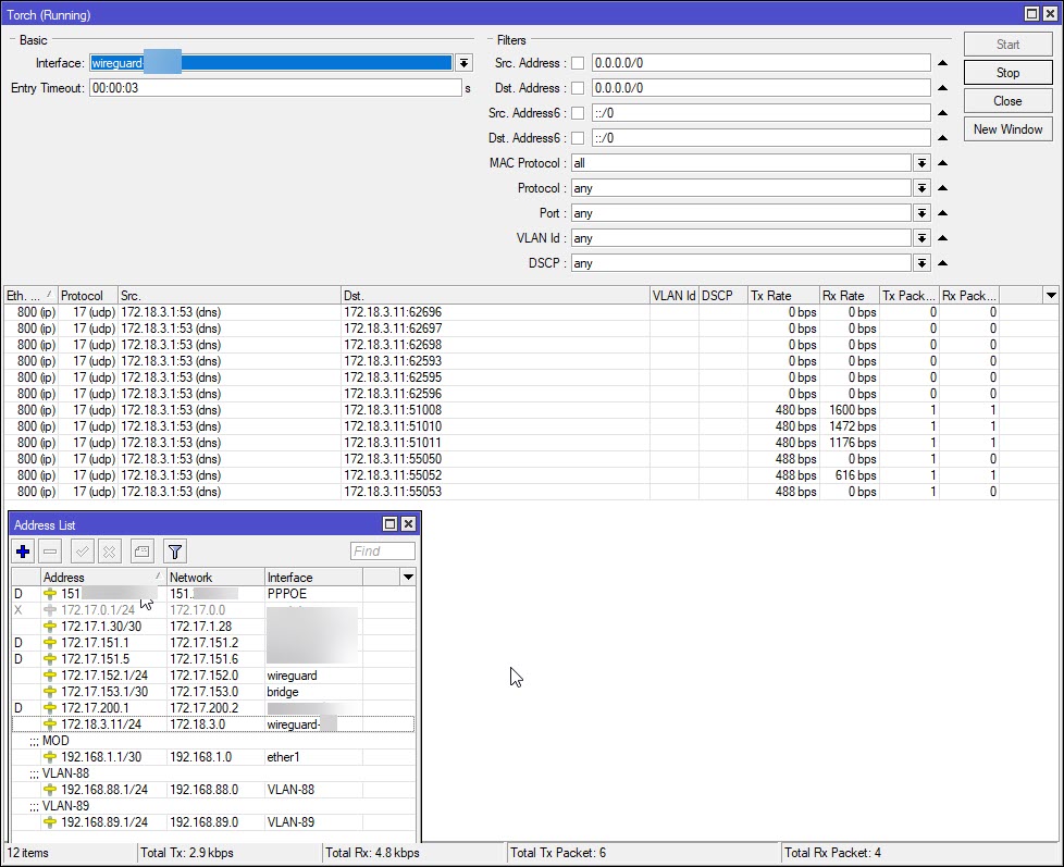

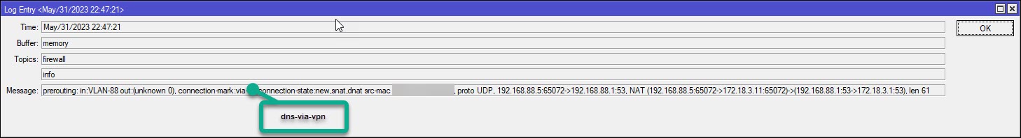

/ip firewall mangle add action=mark-connection chain=prerouting comment="DNS VIA VPN" dst-port=53 log=yes new-connection-mark=dns-via-vpn passthrough=no protocol=tcp src-address="192.168.88.5-VPN-CLIENT"
/ip firewall mangle add action=mark-connection chain=prerouting dst-port=53 log=yes new-connection-mark=dns-via-vpn passthrough=no protocol=udp src-address="192.168.88.5-VPN-CLIENT"
/ip firewall mangle add action=mark-routing chain=prerouting connection-mark=dns-via-vpn new-routing-mark=via-vpn passthrough=no
/ip firewall nat add action=dst-nat chain=dstnat connection-mark=dns-via-vpn log=yes to-addresses="172.18.3.1-DNS-SERVER-OVER-VPN"

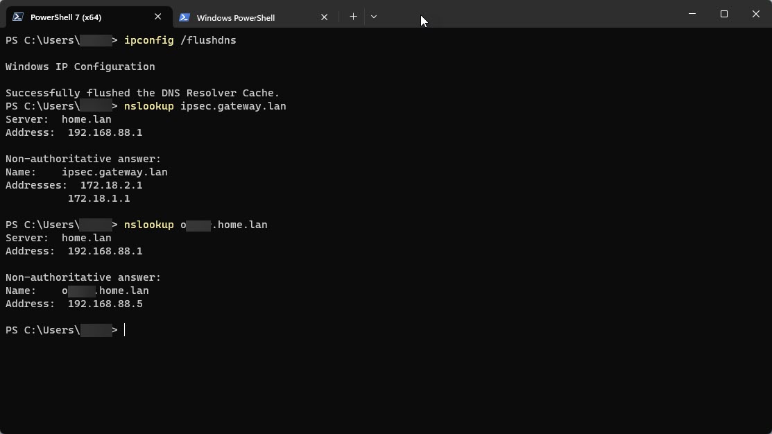

Thanks for the sugestion. They were helpful.
As I understand it, you direct the clients that go through routerOS. Right?

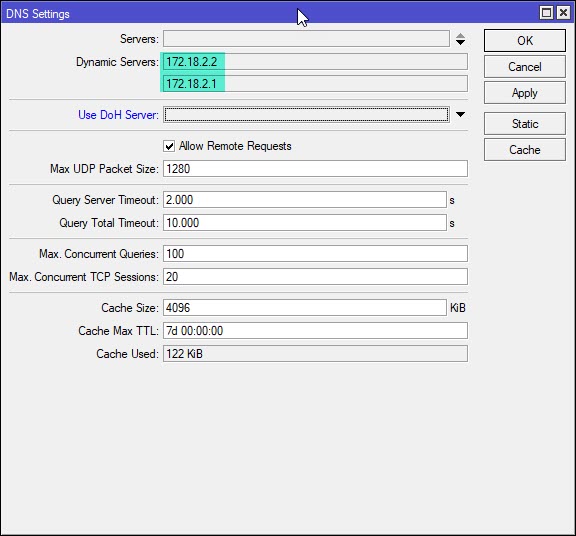

When is the Mikrotik itself that needs to do this query? Would it work?
Imagine that Mikrotik would need to query the DNS names of my network, for any type of validation. Then in the routerOS DNS server settings, the VPN DNS server address would be placed.

Imagine that Mikrotik would need to query the DNS names of my network, for any type of validation. Then in the RouterOS DNS server settings, the VPN DNS server address would be placed.

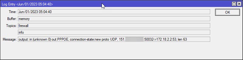

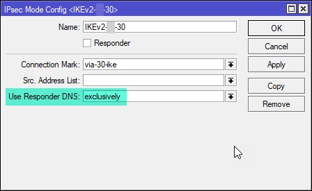

IPsec Tunnel, DNS query from the router itself via IPsec, and clients marked with connection mark.
/ip firewall mangle add action=mark-connection chain=prerouting comment="IKE-30" new-connection-mark=via-30-ike passthrough=no src-address=192.168.88.5
/ip firewall mangle add action=mark-connection chain=output dst-address=172.18.2.0/24 new-connection-mark=via-30-ike passthrough=no src-address-list="SELF" comment="SELF=WAN Interface IP"

I started doing tests like ping, ssh… from Mikrotik itself.
Working but always specifying the src-address.
So I decided to test name resolutions but private DNS on the other side of the VPN.
I set in Mikrotik B the IP of a DNS server that would be behind Mikrotik A.
That’s when I realized that the traffic generated by itself cannot consult, because it does not reach the destination. Because it would need to leave with the LAN address.
