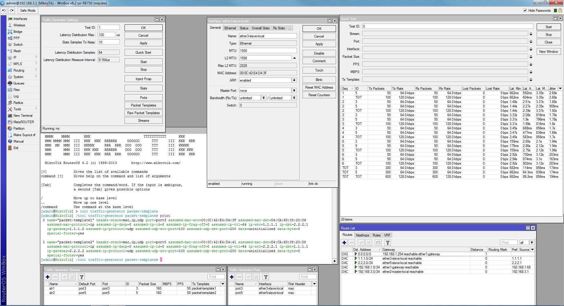

I took a screenshot of my configuration on RouterOS 6.2, see attachment.

My test setup:
Mikrotik 1 eth3(1.1.1.1/24) ======> Mikrotik 2 eth3(1.1.1.2/24)
Mikrotik 1 eth5(2.2.2.1/24) ======> Mikrotik 2 eth5(2.2.2.2/24)
Thanks.

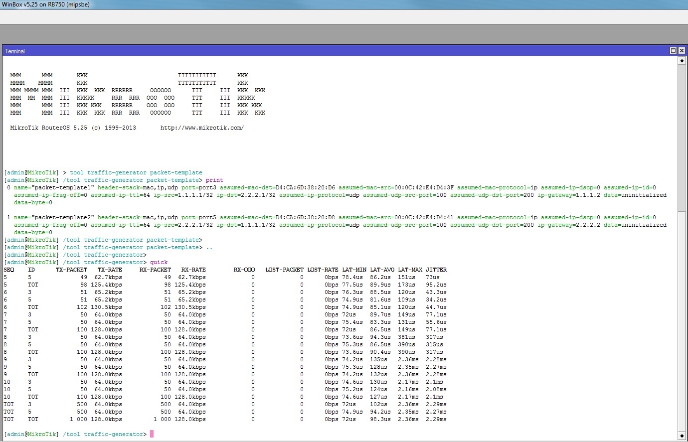

Here a screenshot for 5.25 (on RB750) with good latency and jitter reports.
