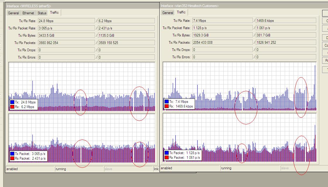

I got the x86 system i got some issues with while traffic flow its doesn’t continiously and get stuck for some seconds and as well it stop real graffing too.. what might be cause behind it?
i got simple queue on it to manage b/w. i’ve attached to snap of my interface and vlan interface too.

Are you sure, the traffic is really stopping for a moment??
I can see this graph “leak” on my very far devices too, but the traffic is not missing any packet, only the graph.

do not worry about the holes in the WinBox graphs - those are separate from the actual traffic itself, as you can verify with ping etc
