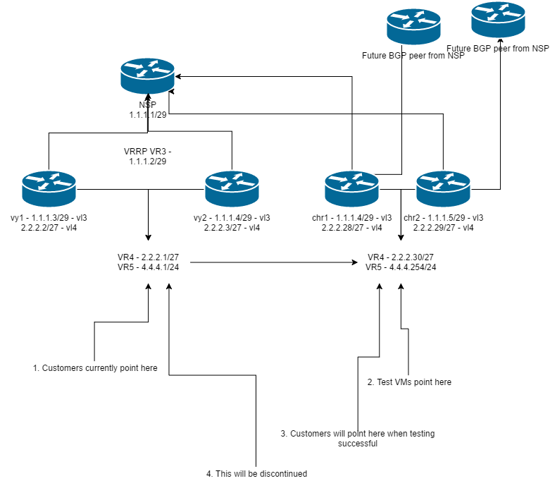

So an update with a little more explanation - kind of should've started it like this sorry.
I'm at the moment moving from one routing system to another and need to do some asymmetric routing to support the transition.
An overview of how this works at present:
NSP (static) -----> HSRP address (vyOS router1 and vyOS router2) --------> VLAN interfaces with the public subnets assigned.
The end goal is in a few months I want to migrate to MikroTik CHR to replace both vyOS routers, and I will do this by migrating to BGP handoffs, discontinuing the HSRP/VRRP handoff. This is kind of the pre-testing of the solution, hence I need some asymmetric connectivity to work. (I want VRF support, hence the move, policy based routing and separate handoff routers gets messy to handle).
The interim goal is to dual gateway each VLAN to not only test client facing VLAN rules, but to then make the transition fairly seamless - i.e. just updating gateway addresses on the addresses we assign to customers.
So as to sum up how the current configuration stands - see the attached screenshot. Logistically, this has worked in the past for other architectures.
The public subnets from the NSP are routed on the VRRP address. I can statically assign small routes to point to the CHRs (dual route with different metrics for basic availability, full subnet and all).
I also tried adding a masquerade rule for the 2.2.2.0/27 on the CHRs, and the test VMs were able to gain connectivity, albeit NAT'd to the /29 of the CHRs. This makes me wonder if there's some filtering I'm not aware of going on somewhere? Though still unsure as I can do an OpenDNS resolver via dig and get the correct public IP of the VM on the test network. But still seemingly drop TCP traffic. To me this kind of suggests I've done something to not observe connection tracking rules in RouterOS - and that would explain why NAT to the edge of the network works?
To mitigate that I've added a static route of the test VM's IP on the Vy routers - 2.2.2.24/32 to 1.1.1.4. I can ping and access this from the outside world, SSH in and all that wonderful stuff. The connection seems to drop every so often and wonder if this could be a sign of expiring ARP entry? Just trying to get a sanity check here!
And just to clarify - I have verified that the MTUs are correct via documentation, tracepaths et al. I'm running at MTU 1500 for layer 3 internet IP traffic - does the L2 MTU keep up with this setting automatically in CHR with VLANs enabled? Tracepath still suggests the max usable MTU is 1500 though, so assume it's mostly correct.
Example configs as they stand now - I'm not integrating VRRP yet, just have the VMs on CHR1's gateway address.
